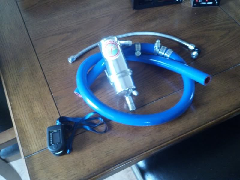

I'm a working stiff, so I'm CHEAP. I am very careful with my airplane funds. But I also want certain things to perform certain ways. I could no longer ignore the results others were having with oil separators and vacuum valves for another step in total performance. I also did not have scrap bin as well equipped as DanH.
So off to Anti Splat Aero for a little shopping spree. I ordered the oil separator and install kit for the firewall forward and the O2 Oximeter for aft of the firewall.
The service has been perfect and the components look excellent. I will try to get it installed in the next week and give a follow up report. I will roll my own for the vacuum valve and exhaust stub adapter.
Kudos to AntiSplat Aero.
