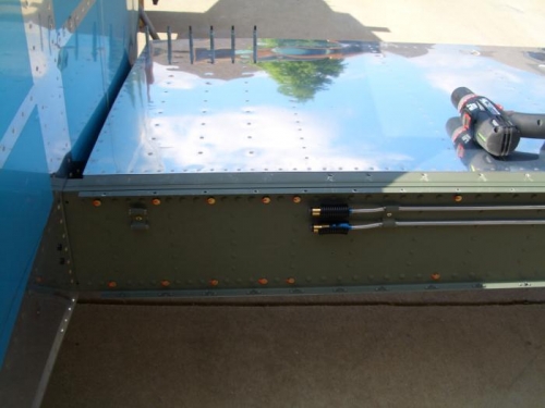

I don't get it. They are in the plans, Vans said they have to be there. Would you buy a car with only one lug nut on each wheel. As someone else said (what else was left out?) What are you people arguing about??

Ok I have to tell the truth I thought I was building an Exp. Aircraft its not the only thing I didnt change I called Vans and ask about the brake line running across the firewall and ask why not use a little extra plastic hose inside and put bulkhead on each side I was told because thats the way its always been done I didnt want my fluid getting hot from exhaust so i have a bulkhead on each side and I think its an improvement.I wanted to build my own F.I. booster pump I posted for advice not one reply but I couldnt not do it so I have a nice booster pump for $250 .Its not in the plans but when I built windshield fairing ran two bids of carbon fiber over roll bar.Not in the plans but that 200hp angle valve looks good up front with its 74" BA.Not in the plans but I moved my stops for aileron to outboard bracket and used #3 bolts as stops. Not even going to talk about about all the speed mods but I love my Exp. RV-6.Good thing Van didnt stop at the 3!
