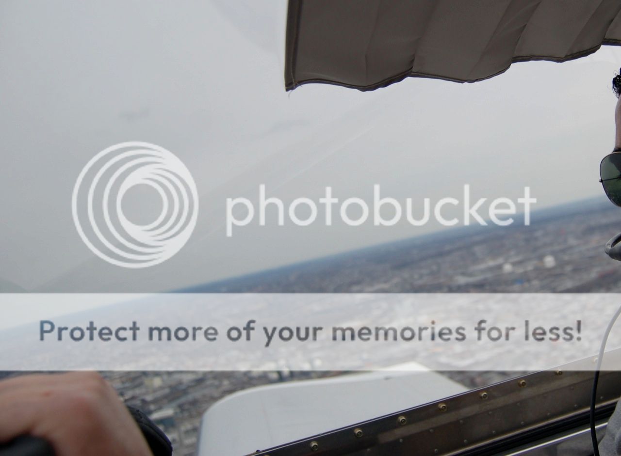

I need a handle on passenger side. Often I fly with a passenger through an airspace which is very turbulent. Here to be exact
It's always bouncy over East River. Couple days ago a 200#+ human autopilot was driving from right seat. He was strapped tight but turbulence made him uncomfortable. He often moved his hand from the throttle to here
I have a tip up that area is very flimsy and his grip was steel. Could easy twist aluminum. I need an idea where to put a handle for passenger. It's not first time right seater is looking for a grip especially when stick is removed. Any pictures appreciated.

I went to the hardware store (Aviation Dept.) and found a chrome drawer pull that just fit my wife's hand.
Mounted it to the right side of the panel. Been working great for years.

I think the face of the F-704K cap strip would be a logical place to mount a handle. Although the Classic Aero interior may create some challenges here.

What about mounting one of these to the same point where the crotch strap attaches, or to the front of the spar?

That's what I did with a hardware store handle and a set of rivnuts. Works great for Julia in turbulence. Worth putting a bit of insulation on the handle and the cap strip, othewise the aluminum can get pretty cold in winter.
