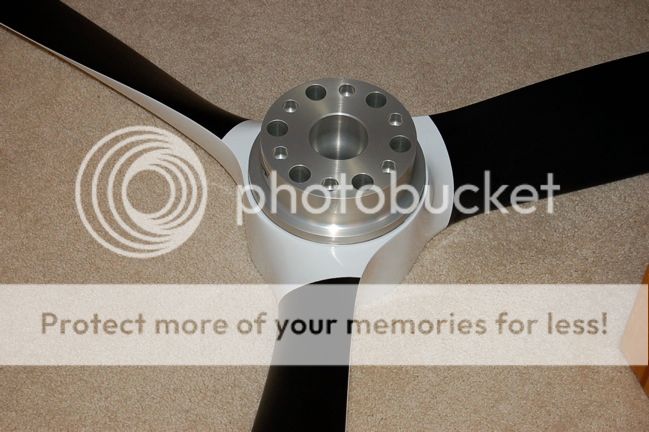

Another vote for Saber. The thing of beauty...
