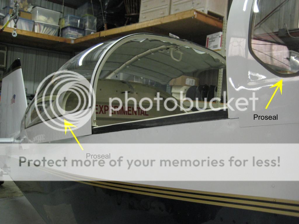

If you can simply unscrew the metal fairing, I would clear out the sealant that is there as best you can and re-seal with Proseal. No problem using Proseal on the plexi. I used it to seal my canopy here:
I might add that using Proseal as you see here protects the paint from erosion as well. The Proseal has been on this canopy for over 10 years.
