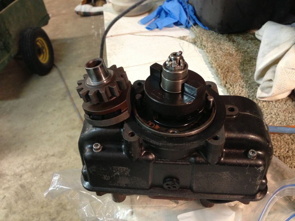

I'm chasing a single bendix mag as well, but mine is for a single hole dual bendix mag accessory case. I would call a reputable mag shop, these 2 shops have been able to send me in the right direction...

Crabandy: Bendix SL4LN-21 mag, part number 10-50360-37 is the one I think you need for the dual mag single hole case. When fitted with the dual mag drive gear and impulse, it meshes with the mating gear at the proper depth and fills the pilot hole in the crank case. If you don't fill the pilot hole in the case, you have a large oil bleed hole that can cause a local low oil pressure area.
Mannan,
Just to clarify, the bendix part # above works with no internal modification. I just need to purchase that # mag slide the impulse off my dual mag and slide it on the new mag. No special tools to remove/install impulse coupling?
As far as I know. There's a couple of mag repair stations that can give you a better reading on this. One I talked to was Shaun at Eagle magneto service at New Smyrna Beach, Fl. Sorry I don't have his phone no. Handy. Try google, should find it.

I think some are misreading the original post. Single mag and single EI tells me that the engine was originally a conventional two mag setup. If this it correct the S4LN21 dash number is -30. This requires a spacer because the impulse coupling moves the gear forward. All two mag accessory cases that I have seen are set up for spacer with impulse, no spacer for non impulse.
