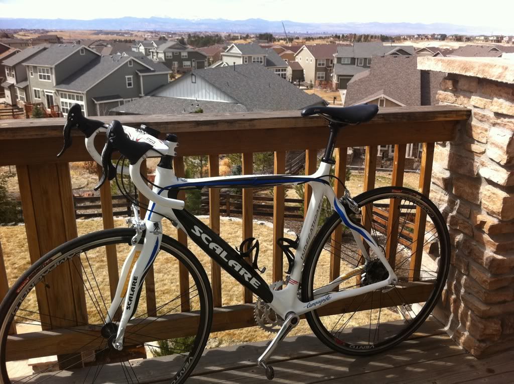

Originally Posted by MarkW View Post
Are those of you using water slide covering with clear or leaving it exposed?
I wounder how it reacts with the clear. Since I am painting my plane with base/clear I had planned on doing the same with the panel.
I can show you some pictures of my bike that I built last year. Most of the graphics are waterslide with the exception of the white on the carbon fiber, that's paint using a paint mask.
After applying the white and blue and then the waterslides, I clear coated over all of it including the bare carbon with House of Kolors clear.
With the exceptions of the white and blue paint..everything else is waterslide printed on a color laser at the office. I couldn't be happier with it and it looks at least as good as any bike costing 5 times as much that I've seen.
What I learned from that fun little project is that someone else is painting my plane! I can do it and it's not even all that difficult..but **** its a lot of tedious work to do well.
Long and the short of it is waterslide really is amazing stuff. You cant see any edges or anything through the clear. I was skeptical, but not any more. I used THIS STUFF

Default Bill - that is one SWEET ride!
Nice road bike...you should get a hobby though!
man, those are some TINY pedals...what size are your shoes.....ONE!
somehow I don't think you oughta leave that parked unattended outside 7-11!
ah, to keep this decal related, I was amazed how good the Brother imprintable label maker worked. quite a bit of flexibility in letter size and spacing, black on clear film actually looks ok...on a beige panel. Probly not so good on a darker colour.
