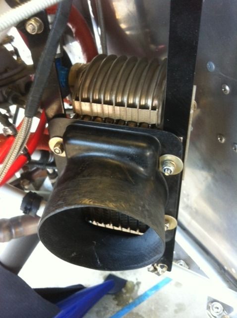

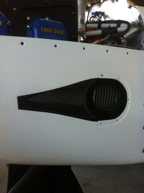

Some basic information first. I completed my 7A in November of 2011. It has an XIO-360 set up with Van's standard 7 row oil cooler. At the time of completion the cooler was mounted in the stardard location behind number 4. My cyclinder temps have always been fine and the original oil temps were about 185. One thing to take into consideration is that early flights were done in the California winter, so temps were probably around 55 or so. In May of 2012 I decided to move my oil cooler to the left side of the lower cowl to test a 4 inch NACA scoop. Here's some pics of the install.
The incoming air flow originally just dumped into the engine compartment. When I tested this setup it was now summer time and OATs were probably around 75 to 85. Cyclinder temps continued to remain fine. A little higher I think, but my oil temps would slowly climb to the 220s when ran WOT for say 5 minutes. Being that it was now summer, with higher temps, I wasn't too sure if the higher oil temps were due to that, or if the intake air was restricted because it dumped into the engine compartment. This could be the cause of slightly higher cycinder temps as well. Too much air in, not enough getting out.

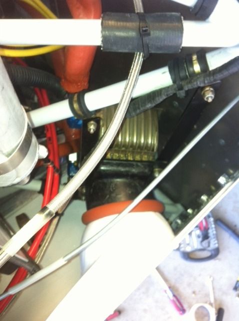

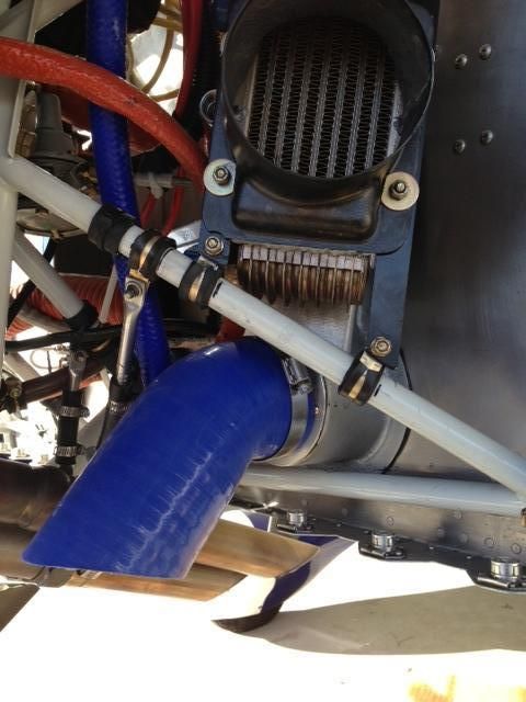

Here's what I came up with. I made a fiberglass duct that would seal around the exit side of the oil cooler and the fire wall forming air path down to the lower cowl. From there, a 3 inch silicone hose with a 45 degree bend would channel the exit flow into an airbox and finally out through a lower cowl vent.
Sorry it's not rotated.
One thing I want to add. Right before starting the rechanneling mods in December I flew it WOT in cold temps and the oil temps still slowly climbed to the 220s.
This morning I made the first test flight with all cooler exhaust air exiting a lower cowl vent. OAT was about 53F and oil temps never saw anything above 180 and I was pushing it. For the moment things look really good but I'll keep you posted as more time is flown off.

I think there's some confusion. The oil temps climbed to 220 when I just had the NACA dumping into the engine compartment. The most recent mod was channeling this air out the bottom of the cowl. From my first test flight today it appears that this modification has returned the oil temps back what they were when the cooler was mounted behind number 4.
Cheers,
Chris Frisella
Www.boneheadcomposites.com
