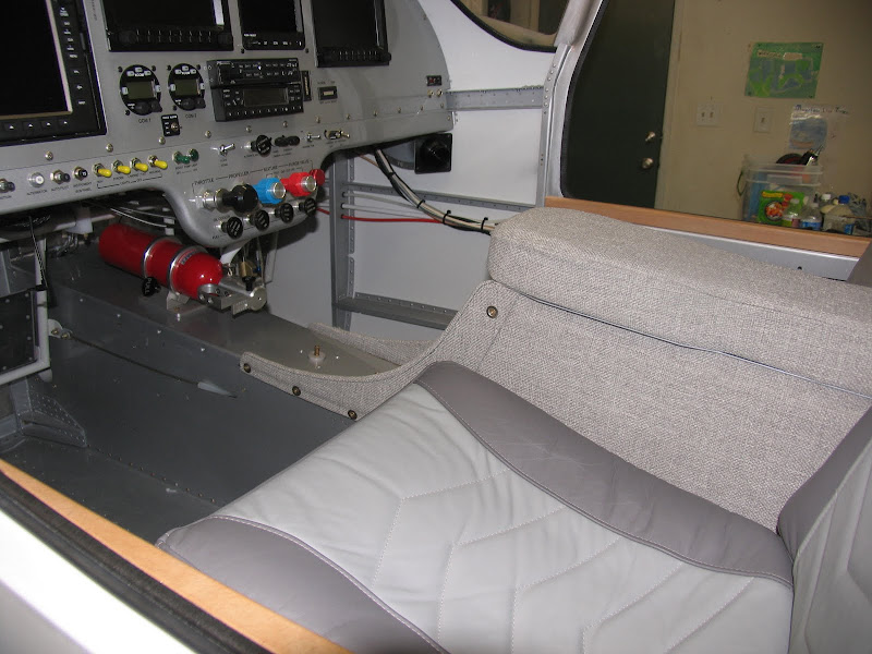

I've been thinking about where to mount a fire extinguisher in my RV10 cockpit. I've got a center arm rest so there is no place to mount it between the seats. I'm wondering where else people have mounted theirs.
I've toyed with the idea of mounting it horizontal under the panel between the panel and the mid bulkhead but it would be hard to visually check the charge on the extinguisher while it is mounted.

I copied some others by mounting mine under the pilot's control stick. Right where it comes out forward of the pilot's seat. Reachable in an emergency and out of the way while flying.

Front and center reachable by both pilots and passengers.
The pressure gauge can be read from the pilot's point of view, albeit upside down. One pin quick removal solution purchased from a local race car shop.
5# Halon is always too big when you don't need it and always too small when you do need it.
I am sure there is more than one good location.

While I haven't mounted mine yet, what I'm planning on doing and have seen in a couple other RV-10s, is that that there is some dead space in front of the seats. Sean identified one location. The others are in the corners. The corner is a perfect spot for the small halon bottle.

As Bob and Sean said front inside corners with 2 small bottles works great.
They can sit vertical and are out of the way but real easy to get if needed.

For you guys who mounted it in front of the seats, has anyone ever banged it with their feet getting in/out? I've kept mine in the seat pocket behind the copilot for a year but would like a better spot.
I've been in and out of Geoff's RV-10 many times. It's never been an issue to me. To be honest, I forgot it was even there until this thread came up and reminded me that I have to mount mine before FSDO shows up for my inspection.

So Geoff's is mounted on the front of the pilot's seat at the inboard corner with the tunnel?
I'll see how it fits under the stick too.
