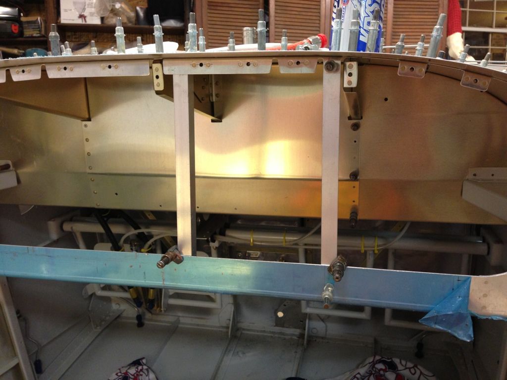

How wide should I make the panel cutout for a radio stack ( gma240 gns650)? Im currently just fitting the vertical 3/4 angle that supports the radio trays behind the panel. The online instructions show 6.3 inches for installation from front or 6.18 from rear, not sure the best option for RV7 slider.

Ok, I think I answered my own question the rack width of 6.3 makes front or rear install irrelavent for now. The manual for the GMA 240 has the rack width as 6.3 and GNS430 rack width at 6.33. If I shoot for 6.35 hopefully it fits, here goes.....
