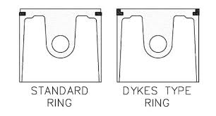

Originally Posted by gmjeric View Post
also has anybody used custom pistons with the ring pack and pin moved as high on the piston as possible
no we make up for it in rod length....when building from scratch get the smallest combustion chamber to leave plenty of quench..design piston as compact and flat as possible....then determine stroke and get the rod last....
My response was to your original post------nothing mentioned about rod length etc.
I stand by the comment that raising the pin height will lower compression, given the info in your original post. Your second post seems to be relating to a clean sheet design..........
What are you looking to accomplish with these design changes anyway???
Rod length is usually adjusted to accommodate stroke changes, or to lower piston skirt friction by lowering the rod angle----which is probably a negligible issue in our low RPM engines.
Your comment about needing to fill the volume above the rings is spot on, specially with our big bore engines.
A Dykes ring can actually be installed with virtually zero volume lost above the ring.
