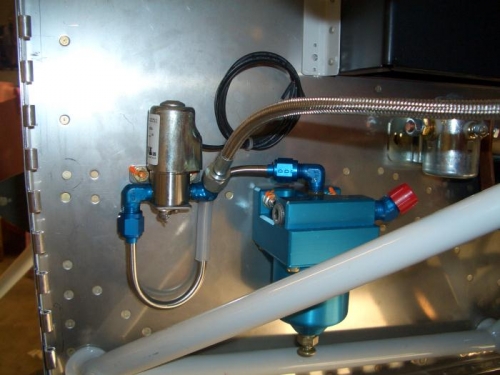

I decided to use a hose from the primer valve to the engine, but how to connect that hose to the copper lines? I thought through a number of possibilities, but didn't have an answer. At the same time I was looking for a local source for the copper tube, but hadn't found any yet.
So the other day I was walking around autozone and out of the corner of my eye I spotted a package of coiled copper tubing. On closer inspection it was 6' of 1/8" line and came with a few compression fittings to adapt to male and female NPT fittings. This turned out to be a hookup line for sunpro mechanical pressure gauges P/N CP7584 for $10.99. What really caught my eye were the compression fittings that came with the line. The fittings are the exact same type as the primer fittings on my previously-enjoyed engine. Now I know what type of fittings those primer fittings are...yay.

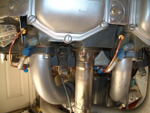

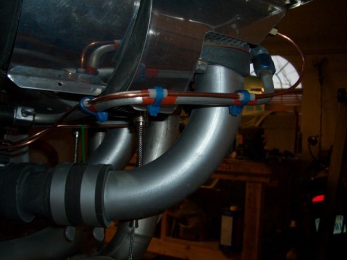

I routed the copper lines. I used the self-fusing silicon wrap to protect the oil lines and some small tubing over the copper line to protect them. The zips ties here aren't my favorite thing, but I couldn't think of anything better. I added a line clamp. I would like to have another line clamp closer to the distrubution block, but there is much I can mount it to in that area.
I played around with the fittings and the best routing worked out to be with the 45* at the primer distribution block and the 90* at the valve. I used cushion clamps to keep the hose away from the engine mount and the cabin heat ducting
