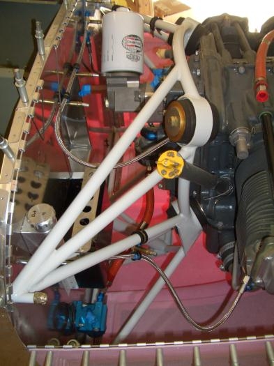

I changed my reservoir out to this version. Not because I had a problem with the Vans model, but I am using DOT4 fluid and this reservoir has a diaphram to prevent moisture getting in the system. Fits great in the stock location with good clearance to the engine mount.

Default Now THAT is aviation quality
Colin,
That's beautiful! Where did you source it?

Originally Posted by Loman View Post
Colin,
Or at least hot-rod quality:
http://www.scottshotrods.com/RemoteReservoir.asp
Machined from a single chunck of aluminum, so no welds to break. Only downside is that the mounting holes are 1/4" coarse thread, It rather they were 3/16.
I removed some material on the back (where you can't see it) to cut the weight a bit. If I had a lathe or end mill I could do quite a bit more.
