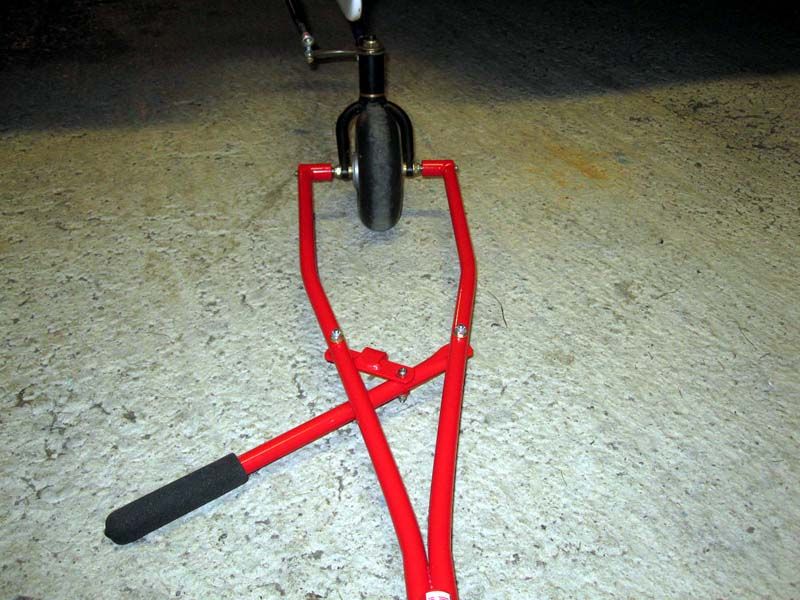

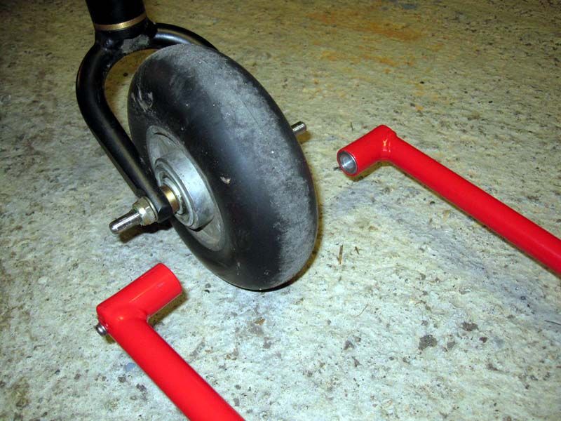

I finally took pictures of the towbar for my -9.
Here is a picture of the tail wheel with the longer bolt and bushings:
Here is the Cessna ?Delux Tow Bar? attached to the tailwheel. Note, I turned the handle 90 degrees and drilled a hole for the pin.
Here is the reason for clocking the handle 90 degrees, my ?tug?:
