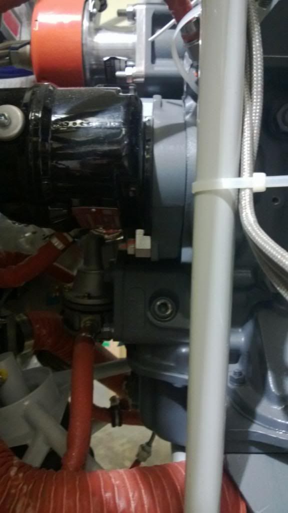

I am installing one of the AntiSplatAero Air/Oil separators and it is supposed to use the oil return in the accessory case. Is this the oil return in question below the magneto in this photo? It is REALLY in there good and taking quite the effort to try to remove. So before I get REALLY aggressive, can someone confirm this is the right place?

Yes thats the one..... but I have the same problem as you it does not want to move and and I don't like how much force I am using trying to turn it.

It probably has some locktite 567 style on it so I'll try heating it up now that I know its the right plug.

Yes, that's the turbocharger oil return port.
