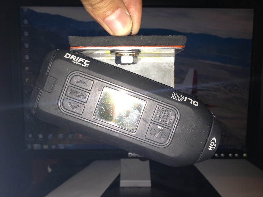

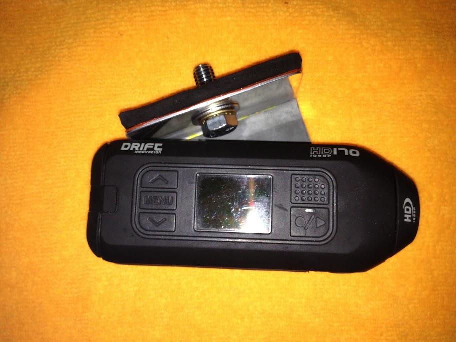

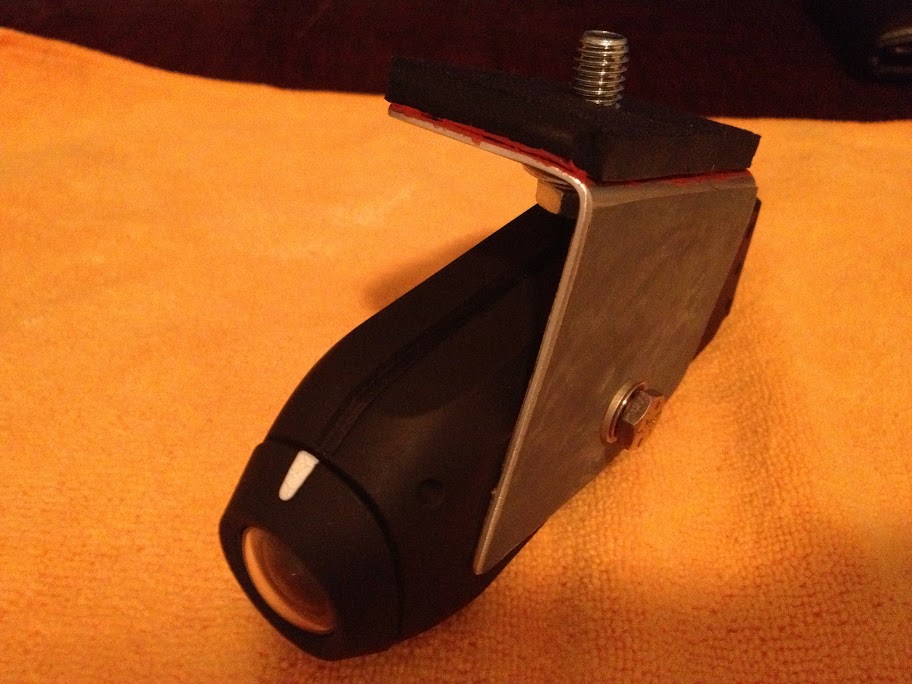

Here are a few pictures. I don't have any pictures mounted on the plane yet. I glued a piece of 2,000 grid sand paper to the inside of the angle so the camera had a good surface to grab onto. The black material on top of the angle is left over wet suit material. Also, a piece that you don't see is a round spacer. The small spacer goes inside the wing mount hole. The bolt goes through the spacer. That way when I torque the bolt down, the wing skin does not see much force. It is transferred via the spacer to the tie down point. When the camera faces forward, i did not have issues. But when it is facing backwards, the only way to get a steady picture is by making the camera and the bracket touch.
