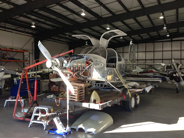

Looks like a -10 made a road landing and sustained damage near San Diego
http://www.cbs8.com/story/20511797/p...sh-near-julian

Here is another link with a pic...
http://www.10news.com/news/experimen...jured-01052013

Default Here is some more info...
Robert Harris
9:35 am on Sunday, January 6, 2013
I listened to the entire conversation between pilot and tower, Ramona. According to the radio communications on tower frequency, the pilot began slow decent beginning at approximately 10,000 ft above sea level. The aircraft experienced loss of oil pressure, and subsquent engine failure. After maneuveringi for apporximately ten minutes, seeking a decent touch down spot, the pilot realized that there was no flat area on which to land, but miraculously landed on a dirt road, exhibiting top level piloting skills. Another pilot in the Ramona area, coordinated with the tower to intercept the estimated touch down location, immediately locating the pilot who maintaned communications between the downed pilot and tower. The RV series aircraft (Vans Aircraft) are popular among home builders, over 7,000 kits manufactured, and among the most reliable aircraft in existence, so the story goes.

Default N262NJ
http://fox5sandiego.com/2013/01/05/p...h-near-julian/

Tail number was posted on the Matronics list. N262NJ.
The builder posted about his first flight here on VAF on 12/27 -
http://www.vansairforce.com/communit...ad.php?t=94560
Some photos from the local news - http://www.youtube.com/watch?feature...&v=IUm3aIuzuZE

Man, looking at the pictures and video, it looks like there were not a bunch of happy places to put it down. That road looks pretty narrow. I will be interested in finding out more about this. It looks like the pilot did a nice job of slowing and putting it in the best place he could.
