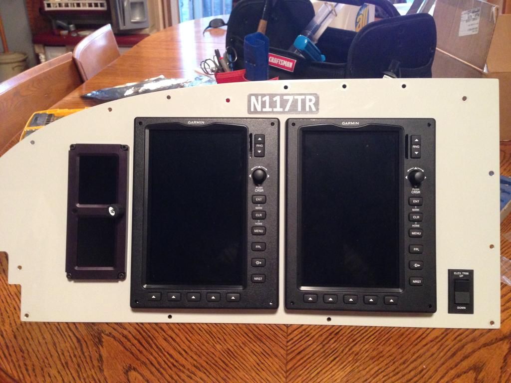

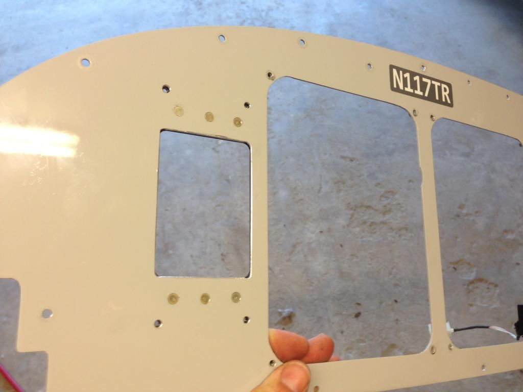

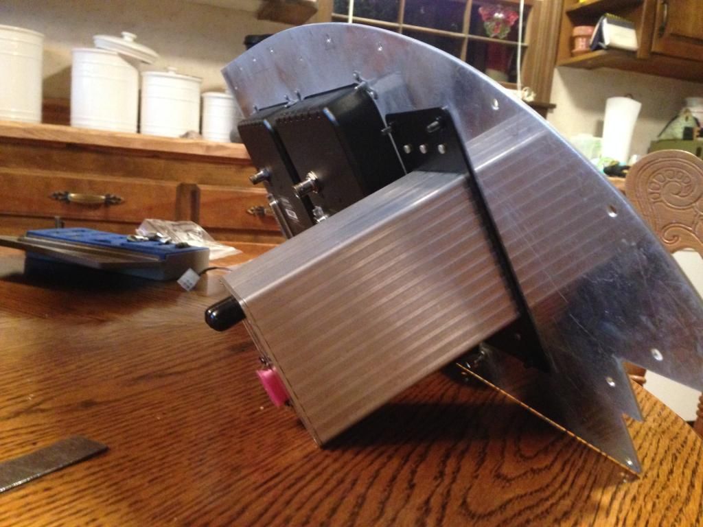

I couldn't decide wether to put my backup MidContinent SAM on the pilot or copilot side. If it's ever really needed it would be much better on the pilot side, but I kinda wanted something for the copilot to see and play with. I finally realized if I put it next to the G3X PFD it would leave plenty of room on the copilot side to mount an IPad. The mount for the SAM used 6 #4 screws, I couldn't get them fit quite right so I drilled them out to #30 and used flush rivets.
The SAM is way deeper than the GDU370's, trial fits worked but that was without the pitot-static and Dsub connector.
