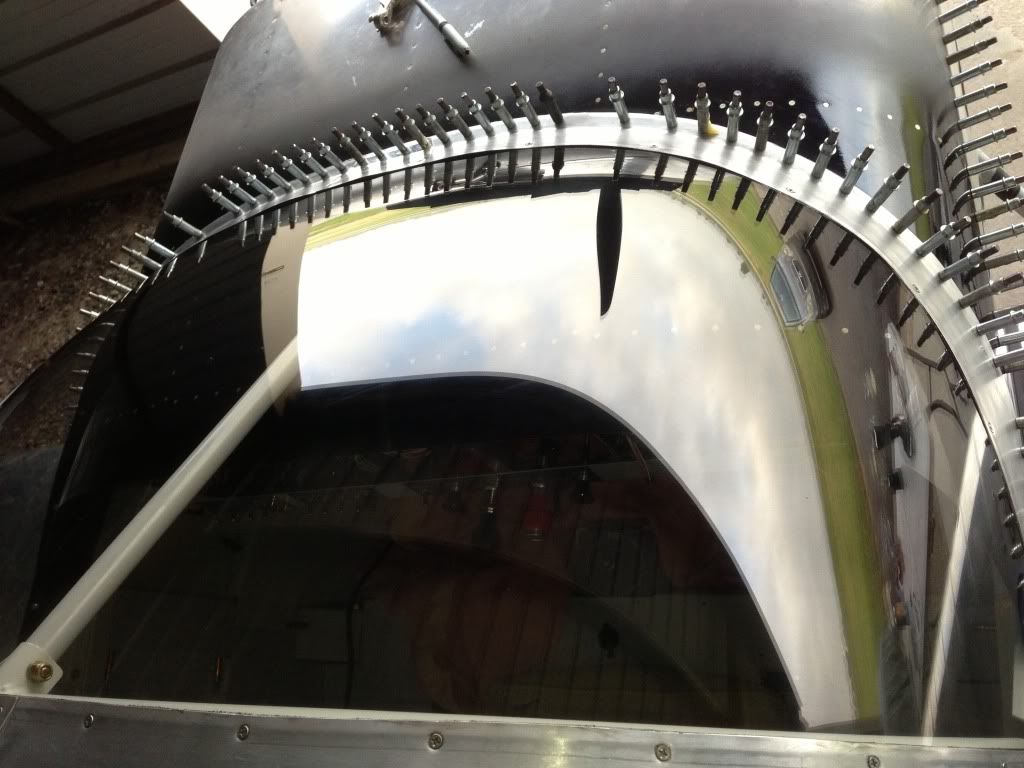

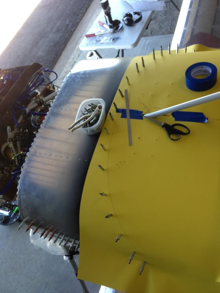

I made some poster board templates just in case I want some sort of fabric glare shield.

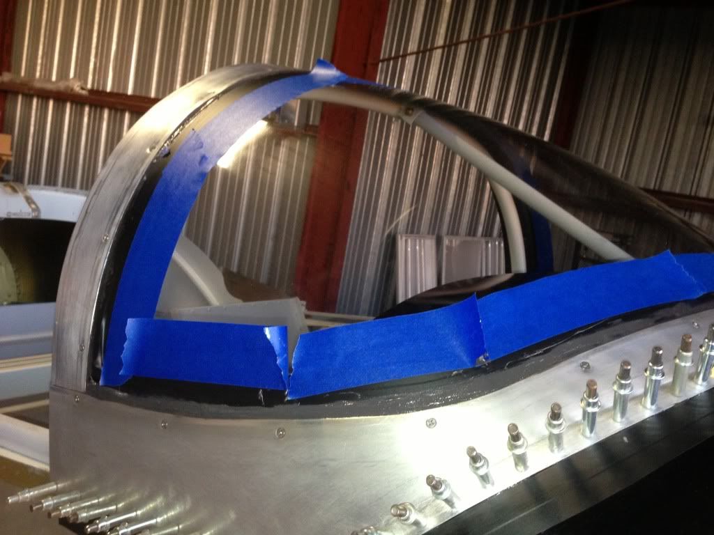

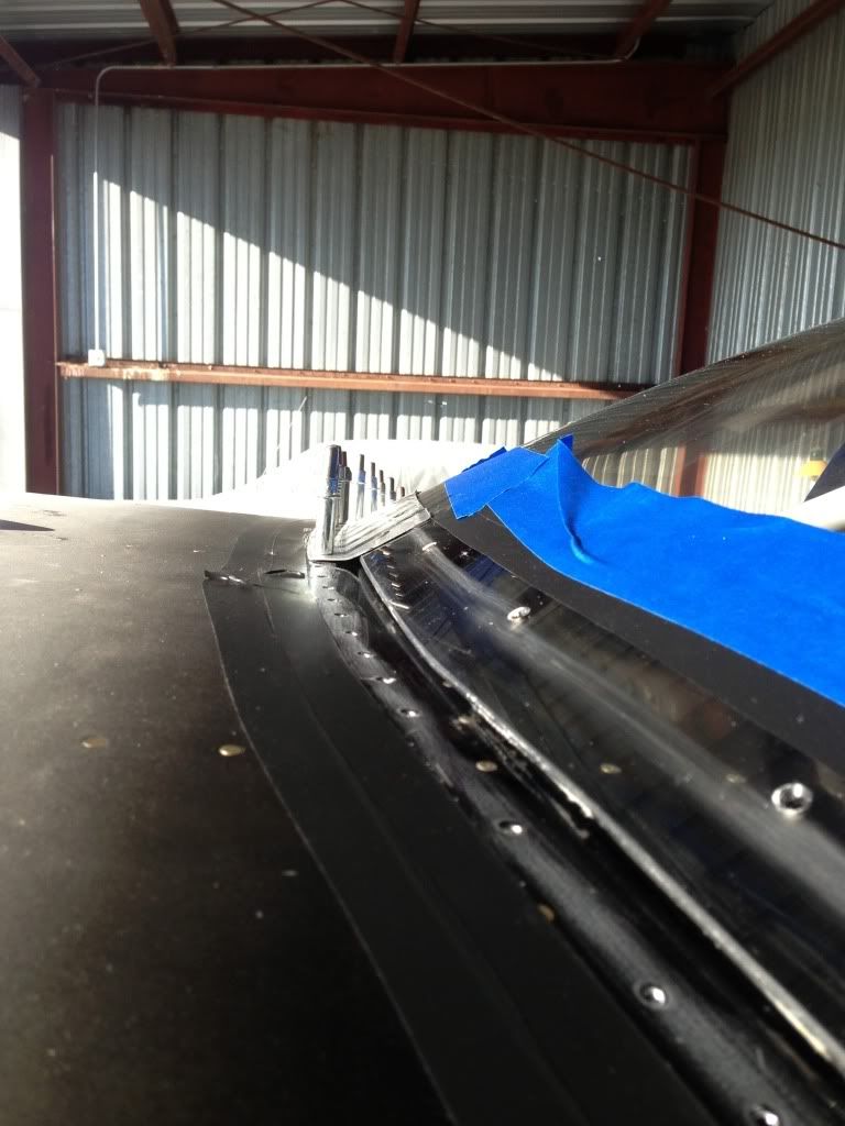

I wanted a watertight seal so I installed the fairings and used electrical tape over the windscreen. I removed the fairings and put a small bead of proseal underneath the fairing, it took some cleanup on the metal with a rag and acetone but I think it turned out all right. I'll know tomorrow when I remove the tape.

Removed the tape and all is good, I will probably touch up the proseal in a few spots to make sure I don't have any leaks though.
Thanks to Ray for helping me rivet the windscreen fairings and longeron rivets. I need some AN426-3-6.5's to rivet the last 10 on each side. They are going to be kinda tough to buck under the canopy deck. These are the last rivets on the airplane, Wow!

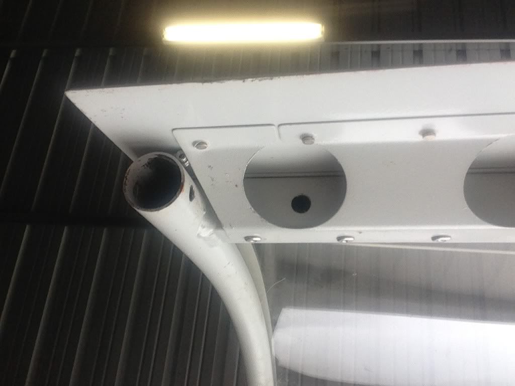

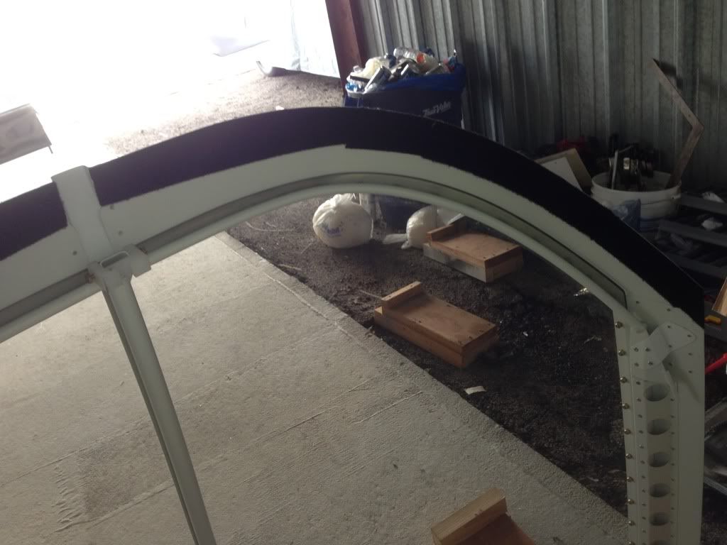

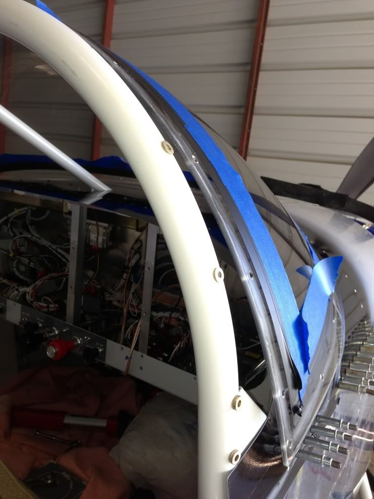

I drilled 1/4 inch holes in the bottom of the canopy horizontal rails so I could shake out the leftover blind rivet pieces.

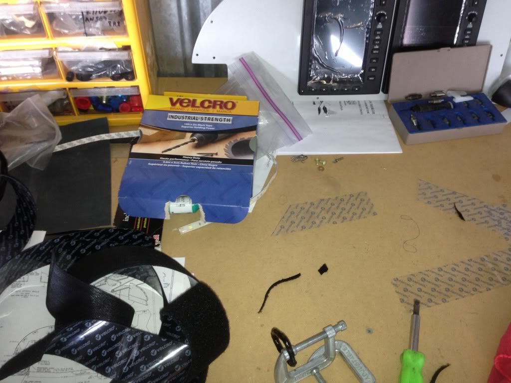

I bought some industrial strength velcro at Wal-Mart, I wasn't expecting much but it's pretty decent stuff, I used the soft side under the rear canopy skirts. The self adhesive works really well, even the little pieces I trimmed off stuck to everything.

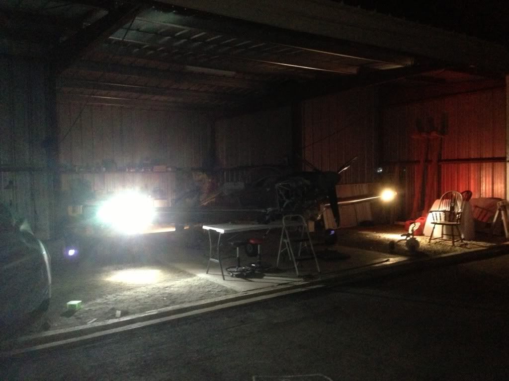

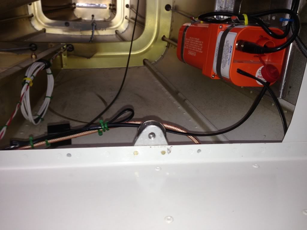

Short session after work and picking up kiddos from school. I prosealed the edges of the canopy in my good clothes, Very Daring! As far as I can tell no proseal on my clothes or canopy where it's not supposed to go! I used a large syringe lots of gloves, electrical tape and cleaned up any stray proseal immediately.
I also installed the $17 battery I finally found at radio shack in the ELT, I still can't believe it was $17 for a battery 1/2 the size of an AA.

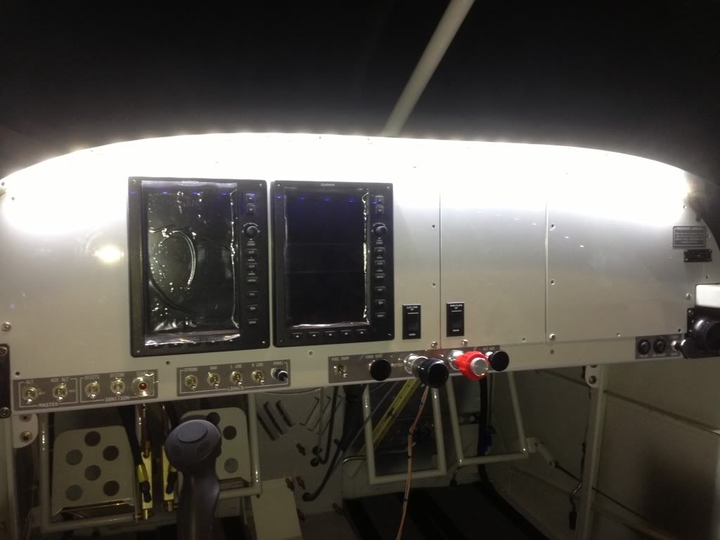

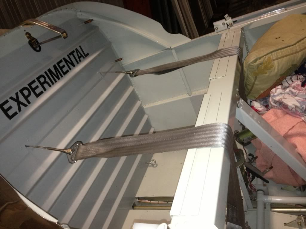

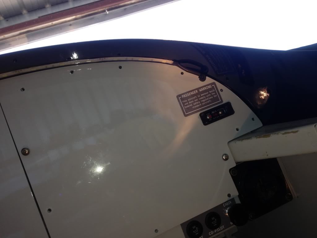

I installed the Experimental sticker, seatbelts and played with the flap position sensor bracket.
I notched a corner of the panel and used a rubber bushing for the wires on my under glare shield led lights.
On the lowest setting with the Kick dimmer, I think it's very doable for retaining night vision and seeing in the cockpit. If anything it could be a little dimmer, but for less than $30 for the LEDs and dimmer I'm happy.
On full blast, it really lights things up.
I took a pic with the Whalen strobes/navs and landing lights on at night, guess which side has the 75 watt Hid vs the 50 watt Hid? Duck works was having trouble importing the bulbs at the time, instead of waiting on an indefinite back order for the 50 watt I put the 75 watt on the right. I'm going to have some aiming to do but will probably use the 50 for taxi and 75 for ldg.
Kind of a crappy pic, the crescent moon through the prop and runway lights looked much better in person.
