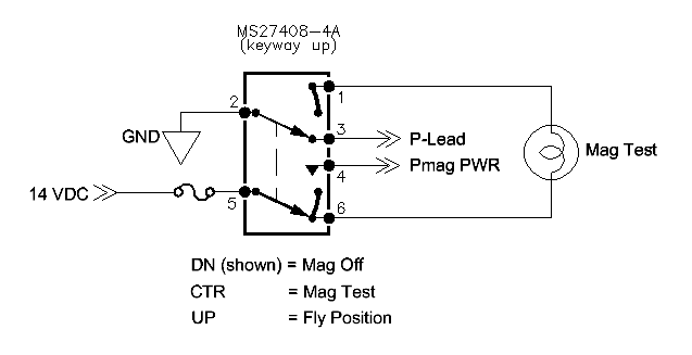

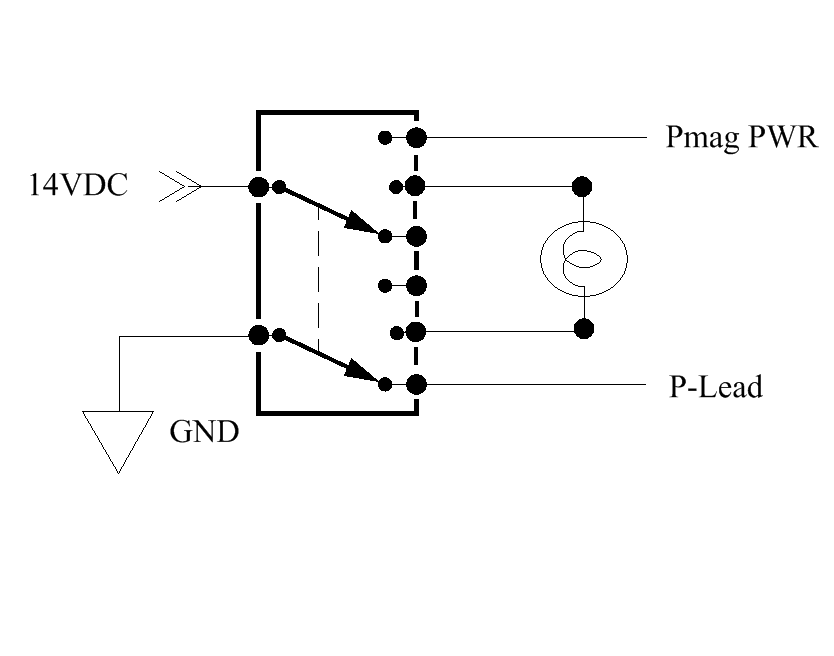

I blew way too much time (hours) trying to figure out the design for a switching circuit for my P-mags. I need to qualify that?. to design it so it will work the way I want. I?m hoping someone with more electrical smarts than me (I?) can help. Part of the problem is I?m also trying for a certain aesthetic as well as function. My design point is that each P-mag will have its own switch:
Military locking 3 positions
Up position (Fly Position) ?P? lead open & Ship?s power closed
Mid position (Mag Test) ?P? lead open & Ship?s power open
Down position (Mag Off) ?P lead Closed (grounded) & Ship?s power open
To complicate it even further I would like to add a warning light whenever the switch is in the mid (test) position to prevent me from inadvertently flying in the mid ?test? position. Does that mean I need a 3 pole triple throw?. and is there a mil type locking lever switch that will do all this?
I have the switch below which is a double pole ?On-On-On? switch which may be part of the problem.
Thanks for your feedback

Bob,
You could wire it like this using your existing switch (EDIT: See corrected drawing in later post):
Edit: Of course you would need the necessary circuit breaker or fuse per the Pmag installation manual, etc.

I guess my schematic would not work with your existing switch (double pole double throw or DPDT). The schematic shows a double pole triple throw (DPTT). Sorry.

If what you have was double poll / triple throw, it would have 9 terminals.
You have a double poll / double throw (based on your photo).

Have a look at page 6 of the following link. http://www.aeroelectric.com/articles...r_Switches.pdf
I think your switch is similar to a 10-2. If so, I believe you can accomplish what you want by connecting the terminals as follows:
1) Idiot light Ground
2) Ground
3) P Lead
4) Pmag Power
5) Bus Power
6) Idiot light positive.
There is a very good chance I don't know what I am taking about, so make sure you test first.

Bob,
John (J CRATE) has it right. It should work if you connect it up as he posted. As he said, test it first.
I will post a corrected schematic tomorrow.
EDIT (12/27/2012) - Here's the corrected drawing for DPDT ON-ON-ON switch:
