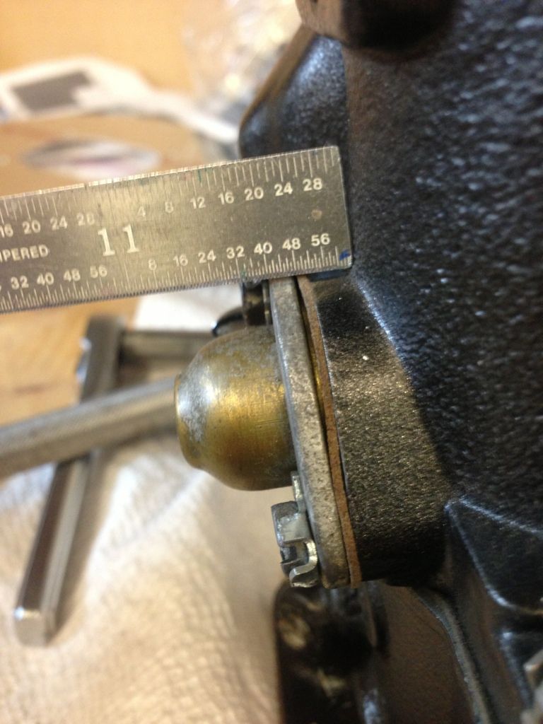

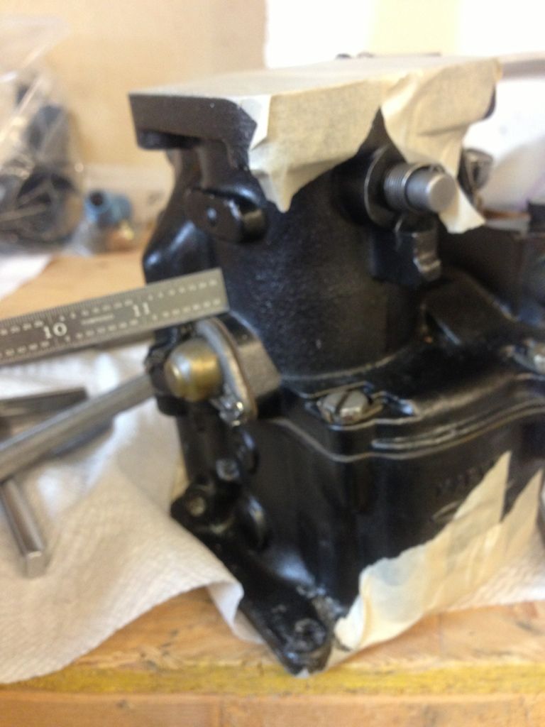

Another question for anyone, the flange holding the Bowl Vent Strainer Screen Housing is warped. Should I
a. Leave it alone
b. remove, hammer flat and reinstall
c. remove, turn inside-out and reinstall
d. order a new flange
