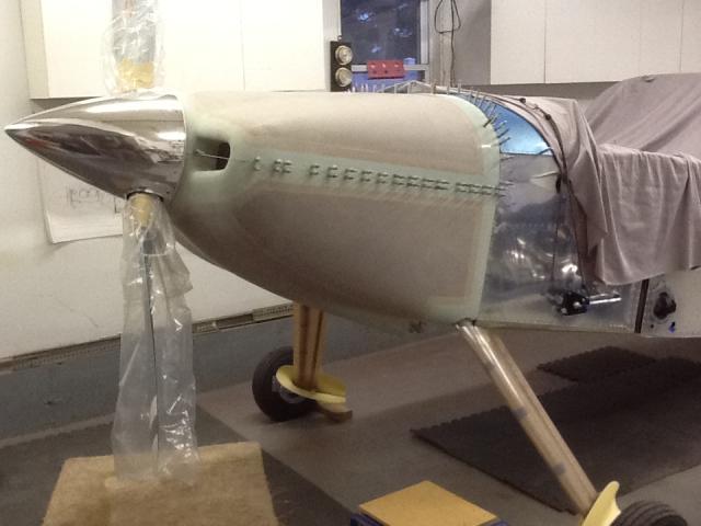

Truth be told, nothing performs dollar per knot than a good wooden Sterba for $700 or so. But I am a button pushing cowboy and I like fiddling with things in flight as I get bored easily... hence I NEEDED a C/S prop.
I REALLY liked the PCU 5000 governor. I talked to Bob Hoenig from Ameritech Industries and set up a group buy for them back in the early days of this forum when we were allowed to do that. I got MANY PCU 5000's at a very reduced price and MANY (I think well over 100) people here now have those guvs on their planes.
If you aren't familiar with the PCU 5000, google it up. It is a FANTASTIC guv!
This is what it looks like with the polished Hartzell spinner!
CJ
