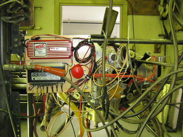

Also, if you like standard mags and want electronic ignition, check out G3i ignitions. Thomas Spakow is on these forums and he sells them. Larry Vetterman (yah, the exhaust guy) uses it and loves it!
I installed my G3i boxes on the top of my firewall. It ran GREAT in Mattituck's test cell!
CJ
The experiment works!

OH, and here it is mocked up in the test cell at Mattituck.
DAM, I am gonna miss those guys!
They were great! Thanks again, Mahlon!
