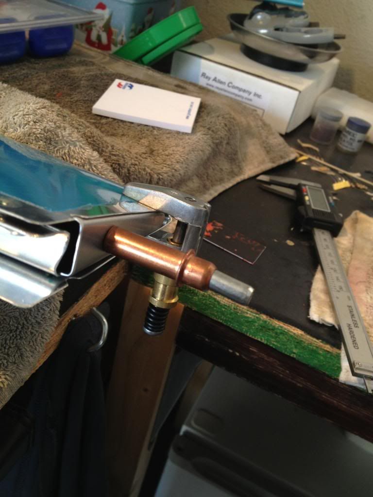

Here's a visual representation of what I did:

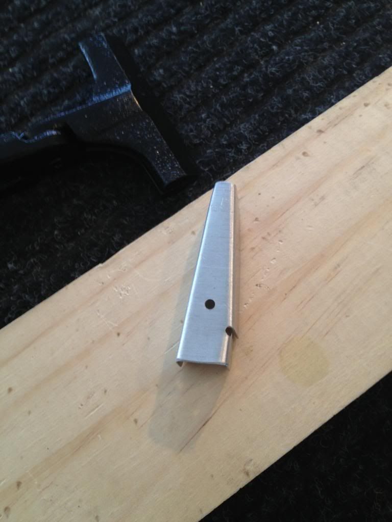

Measure and cut each rib's tip to its final size. It is always better to cut more than the minimum, in case of any screwup.
The same goes for the Trim Tab and Elevator Skin Flaps
Deburr edges and corners.
Measure the distance where the rivet holes will be drilled. Minimum edge (margin) distance is important here, so measure according to a reliable reference, such as MIL-R-49196A.
Draw the rivet line and rivet-to-rivet distance separation (pitch) (remember to measure from rivet center)
Drill the rivet holes on the skin first. These will later be used as pilot holes to drill the riblet's rivet holes.
If you decide to attach the riblet to any Spar and it's holes (highly advisable), you will have to bend both riblet flanges and drill a relief hole for each of the bends.

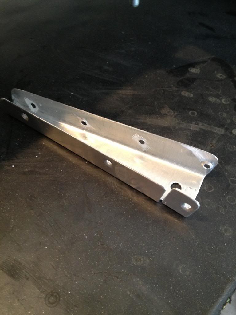

Finished machining of one of the riblets. This one attaches one flange to a spar, as you can see there is only one bend. An extra 1/8" hole was also drilled at the center of the riblet web. It's used to attach a 1/8" cleco which will serve as a grip to handle and move the riblet in place.

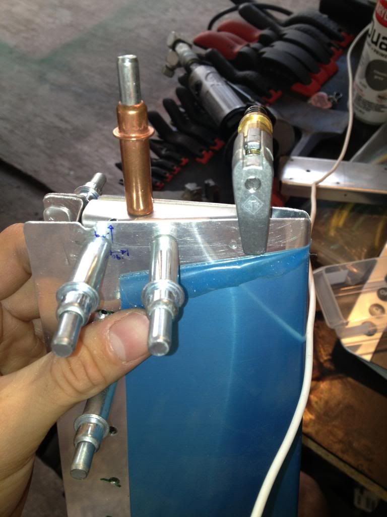

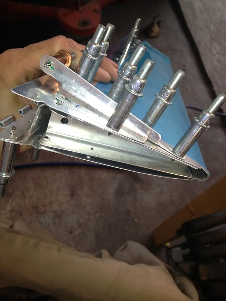

Next thing is to position the riblet in place and hold it secure with cleco clamps. Drill/match-drill the rivet holes.

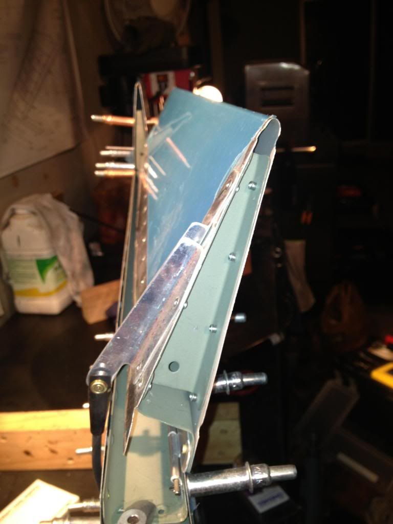

And begin final fitting and installation.
Where regular solid rivets are hard to squeeze, Life saving MK-319-BS or CS4-4 blind rivets can be used.
Final product..
