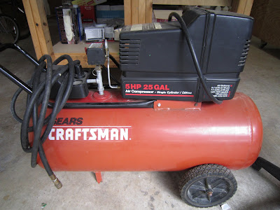

I run this one 97% of the time and it's been just fine. Belt driven, oil fed, cast iron twin cylinder, 5.5cfm @90psi, 115v, 20 gallon. Cheap used on craigslist.
For the other 3% when I'm painting or heavy diegrinding, I run this in the backyard (different circuit plus it's noisy) with an air hose and "T" into my airline. Very cheap used on craigslist. Would love a big 240V but this setup has worked fine even for HVLP painting and everything else I've needed and it was cheap and will be easy to take to the hanger.
