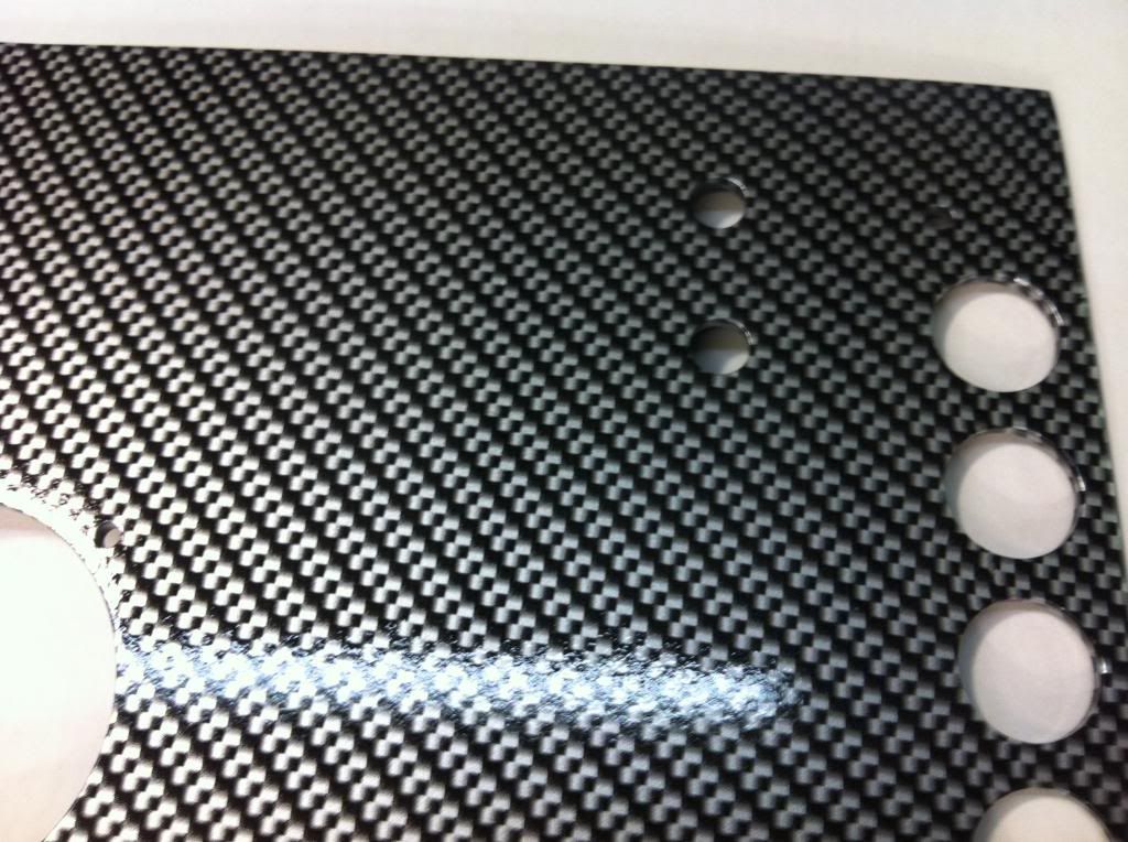

i use all auto grade urethane paints from matrix. i can dip a part 3'x 6' although 3' is max i like to stay around 30" to give myself sufficient room to move around a bit. i can dip a part that is 6' long could get a 7 in there but again would be pushing it.
over night in my heated paint booth is enough dry time to release the part back to the customer. although not fully cured, the clear will with stand handling but if dropped it might leave a small scar.
i can clear any pattern with gloss, matte or flat i have all clears in stock. generally the hunters want matte or flat but it is all what you want as an individual. i think dash panels look the best with a gloss to give it the high end look.
if you are interested in pricing you can shoot me some pics of the parts and i can give you an estimate.
12x12 $30 12x 24 $50 12x36 $75 not including the film. film is from 3.00 to 12.00 per square yard depending on the pattern. the films with more colors are more expensive. carbon fibers are 6.50 per yard

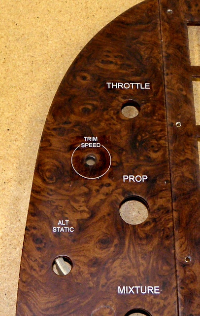

For those wondering how people get the "burl" look on many of the panels, this is primarily how it's been done. If you look at Phil's pretty "burled" RV10 panel you'll see he had the main frame dipped, then painted the plates a contrasting color. This is a proven technology that has been around for awhile (quite popular with gun stocks, bows, performance car parts, etc..), but not a ton of people have used it for their panels. That said, it's an excellent option if that's the look you're going for!

Nice looking stuff, just wondering about lettering. I had planned to use the lettering available from Stein's, as I understand it they are applied and then clear coated over it.
Would this be a problem? I would think your clear finish would need a light sanding before the lettering is applied and then cleared over it? Long as the clear I use is compatible with your system.
Or if I was willing to pay your hourly rate, could they be applied before you do the final clear coat?
Cheers, Terry.
  #16
Old 11-29-2012, 04:50 PM
SteinAir SteinAir is offline
Join Date: Feb 2005
Location: Minneapolis
Posts: 2,473
Cheers, Terry.
Indeed it works just fine. Below are some pics from a Velocity panel we did last year, also dipped (customer wanted a walnut burl)...this was a gorgeous G900X panel! Note these pictures were before the clearcoat (sent to the customer for approval before we clearcoated them) and it turned out great...unfortunately I managed to misplace the pictures of the finished product - and when it was finished the decals of course dissapear and the lettering remains. In this case, we did in fact VERY lightly sand with high grit before the decals were applied, then clearcoated with a satin/semi gloss paint - don't use flat or matte as it looks poor!

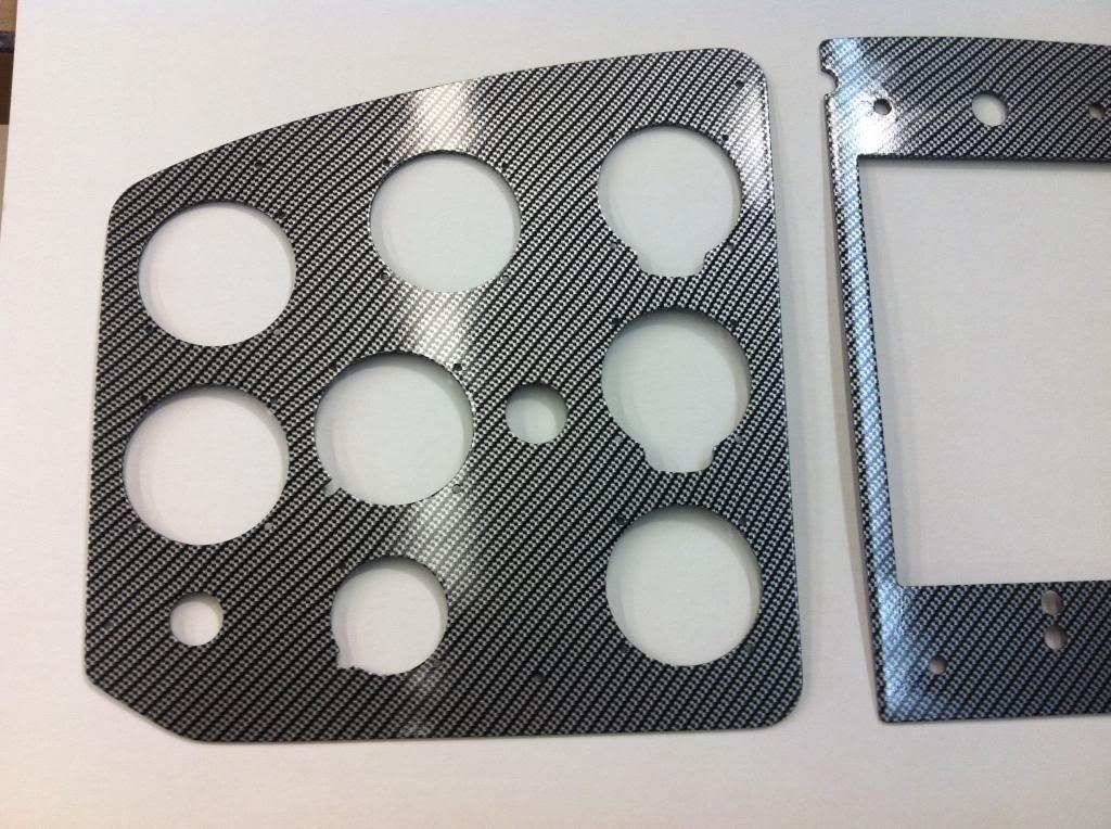

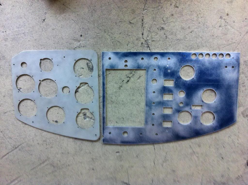

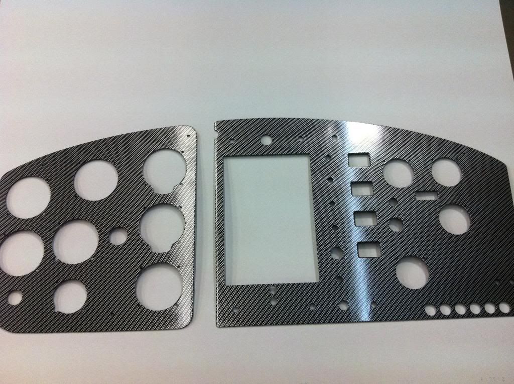

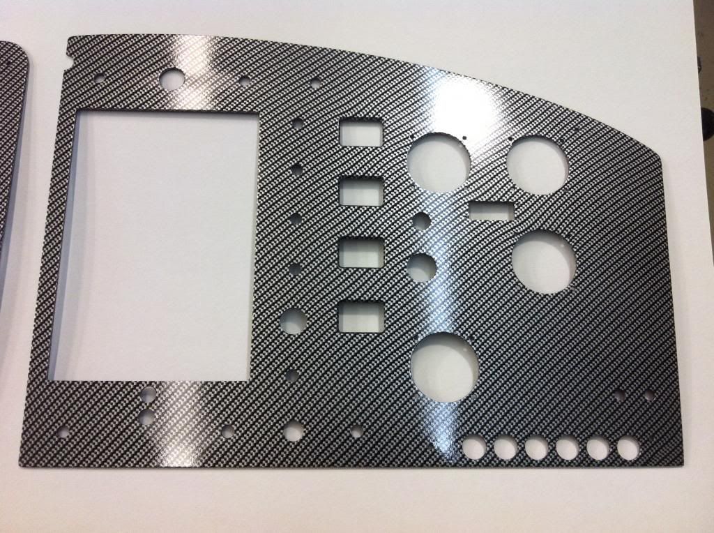

special thanks to Fred for letting me dip the dash panels in his cessna 150
it came out great! i think its gonna look awesome once he gets all the instruments installed.
before ( cant figure out to rotate it)
[IMG][/IMG]
after dipped in carbon fiber
[IMG][/IMG]
[IMG][/IMG]
[IMG][/IMG]
[IMG][/IMG]
