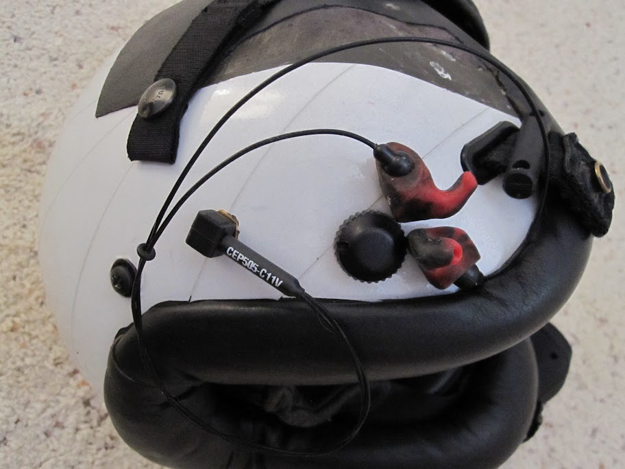

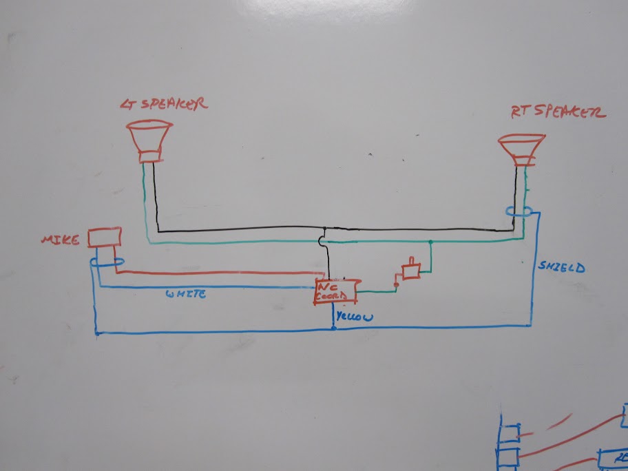

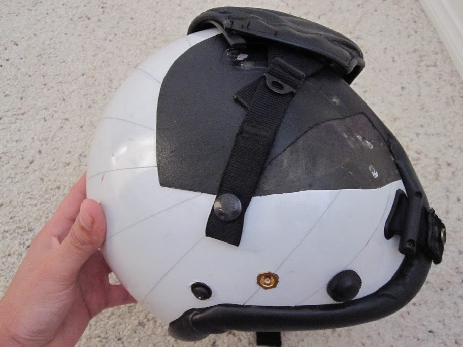

Yes. This is what I did. I called Westone and spoke to one of the engineers regarding the differences in military and GA impedance. He explained to me that yes the difference is there however it should not affect the CEPs. So I decided to give it a try. I took an H10-60 David Clark headset apart, bought the CEP hookup and made the mods to my helmet. You can also make the mod to your headset (check for intructions on their webpage).
H10-60 drawing:
This is the drawing I made.
This is the outcome.
I fly with a Bose headset sometimes and with the helmet the other times. I don't change the aduio level on my intercomm or headset/helmet at all from one to another (the helmet also has volume control just like the headset). Non of my buds know the difference when they hear me over the radio. All that being said, the noise cancelling headset is still a little better than the helmet and the CEP combo. Good luck to you if you decide to do it. Took me about 1.5 hours to figure out and do.
