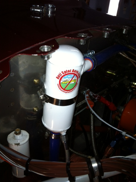

Default anti splat air/oil separator installed
I don't have any performance numbers yet, as I just installed this today and have made one flight. I replaced my Airwolf Air/oil separator and added the Antisplat aero separator. As a DAR I have seen many of Allan's products on RV's and I have been really impressed, so I decided to try this one myself. It certainly is a lot less complex of an installation than the Airwolf, except for the required welding of the stub onto the exhaust system. As you can see in the photo, I did add a brace to the stub just to prevent any cracking of the exhaust pipe. It probably isn't necessary, but I'd rather have done it and not need it than to have to repair it later (like on a trip to Alaska).
I know there have been some posts related to increased HP, and I hope I get those same results, although I am not sure I will actually feel the difference since the 10 has a constant speed propeller and is already quite exhiliarating at takeoff. I currently have the oil set at 9 qts after a fresh change, so I will update here in the near future.
By the way, the kit was first class. All parts were of very high quality, and all required parts for a complete installation were there. No need to call Spruce. I like it!

I've got about 12 hours now on the Anti-Splat spearator that I mentioned in an earlier thread, including a couple of 3 1/2 hour legs. Not a lot of time, but some interesting things I thought I would share. I have over 600 hours on this RV-10 now, so I have a pretty good feel for it's performance and behavioral characteristics.
First, the ground idle has picked up about 50-70 rpms. So much so that I need to turn it down, but am not looking forward to pulling the cowling down again so soon, so that will wait for a while.
The belly is the cleanest I have ever seen it. Prior to this on a 7-8 hour trip there would be a little film of oil on the belly. Not so anymore. This might be due to the fact that we now have it draining into the exhaust, but it sure is nice!
Last, and certainly not scientific, so I am sure I will get eaten alive on this board, but I feel pretty confident I have picked up 1-2 knots in cruise. We make this particular trip to Ohio from Atlanta, up at 9K' and back at 8K' (not any higher this time of year due to temps and icing), and I normally see an indicated TAS of 168-169 knots. Once in a while it will touch 170, but not stay there. On the trip this week end it was always a solid 170-172 knots. Both ways. Two different days. Time will tell, but if the 7-8 HP claim of Allan's for the device is true, and the old "cube root of the HP increase yields the TAS difference in cruise" then the increase I am seeing seems right, as the cube root of 7-8 HP is somewhere between 1-2 knots.
As always, your mileage may very, but I am very happy.
