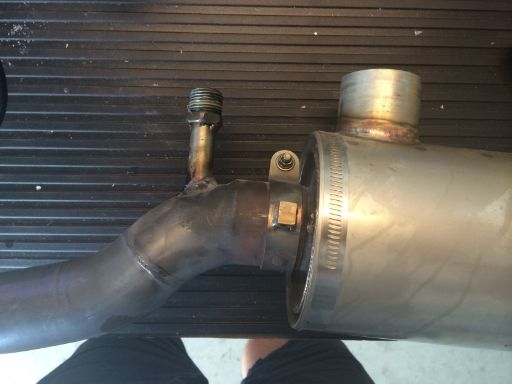

Installed a second Reed valve today.
Like Dan Horton, I do like the idea of negative pressure in the crankcase and I am not quite ready to do away with the idea of the crankcase breather line plumbed into the exhaust. However, there is enough evidence at this time that stubs welded into the exhaust tubes will coke up and create a potential for a crankshaft gasket to blow out.
Here is my install, I pointed the valve up so as not to have an oil drip after shut down.
Ernst Freitag
RV-8 finished (sold)
RV-10 Flyer 600 plus hours
Running on E10 mogas
