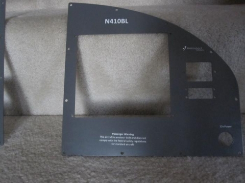

Most of mine are 12pt font. The N# is 36pt.
Just print them out and experiment on what looks best for your panel.
My pictures aren't the greatest, but it will give you an idea.
The lettering is dry transfers that you can have made at any printer or graphic design shop. In my case, It was a fixed rate for everything I could fit on a single sheet of paper.
