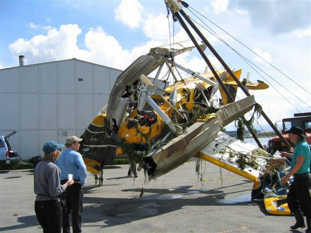

Default I would not recommend
I would not recommend the mounting method shown. The hammer will become a missile in any significant impact...I know this from experience. Everything needs to be securely tied down in the cockpit or it will become airborne in a crash. This little device should be carried in the pocket of a flight vest with a zipper holding it shut. If your not wearing it, it's not going to be where you think it is.
