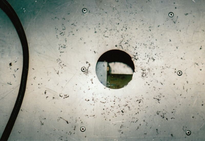

I'm not wanting to make the floor completely removable as that is more work than I'm willing to go through. However I am fearful that one day my steps will crack and need repaired/replaced and I need access to the bolts that hold the step under the baggage floor.
I had this idea and wondered how smart it is to remove a small section of the floor. The plate is the VA-195D from vans. I would not try to make this flush with the existing floor, but place it on top. Using a couple screws along the rib and the rest of the screws under the baggage floor.
I'm just a bit worried about how flexible the floor might became after removing that piece. Is this a bad idea?

I did it several years ago to make the steps removable for racing. My removable cover plates are smaller and I do have a carpet on the baggage floor but there is nothing to it and there is no risk. The steps are oh so convenient and the difference in speed is a fraction of a knot but I do remove them for racing since around 2008.
In this area of the modification I took a circular hole saw in an electric drill and made a entry/working hole in the floor in the approximate location of the bolt then I elongated it to what actual was necessary to facilitate removal and reinstallation. When I finished the hole I made a cover plate to overlap the edges I have a flat head screw at each end with two mating dimpled platenuts riveted to the baggage floor and I dimpled the baggage floor and cover plate of course. I repeated the process for the opposite step.

I pulled the baggage compartment floor out on my -6A to repair cracked step on passenger side after discovering a crack around the 100 hour mark or so. Before reinstalling the floor panel, I cut access holes and cover plates so I won't have to pull the floor if it happens again. I installed reinforcement rings to maintain floor strength and keep the access plates flush. Haven't had any trouble with this fix and would do it during initial construction if building again.
