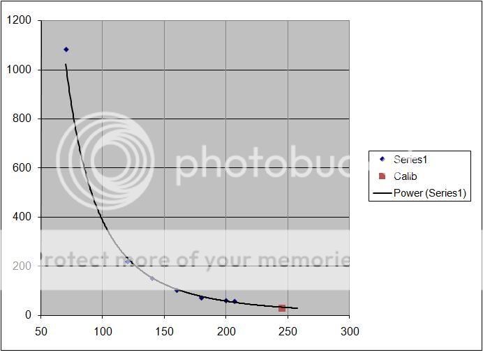

I think Lycoming makes several single pin sensors. The one I measured was resistive, and the 0.3 ohms you mention would be a pretty neglible error.
Here is my chart, ohms vertically and degrees F horizontal. I'm too high to get 212F as boiling...
For the certified SW gauges, the meter calibration point is the red square - 33 ohms at 240F.
Were your measurements similar?

Thanks... perhaps you can do a few resistance/temp spot checks and confirm the curve you have is similar to the one I showed..
I was surprised at the steepness of the curve.
The curve on the graph is a Excel one generated from the points shown.
The 33 ohm reference came from the Grumman maintenance manual on how to test the SW type meter indicators. Replace the sender with a 33 ohm resistor and the indicator should read 240 F.

Gil, if convenient would you email me your data for the graph. I'll put mine on the same spreadsheet for comparison. My email address is jdalmansr@gmail.com. Depending on workload today I will go to the hanger and make the measurements. Seems like the 33 ohm test would be very useful for checking the gage out and eliminating one source of trouble.
