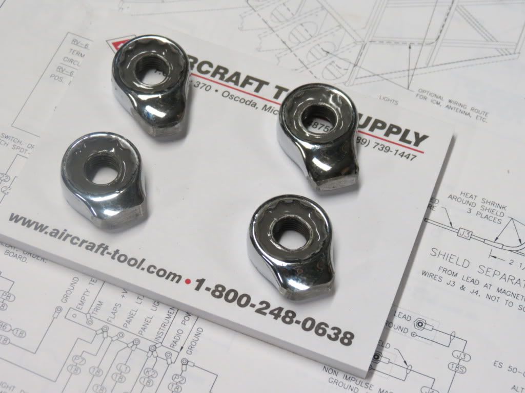

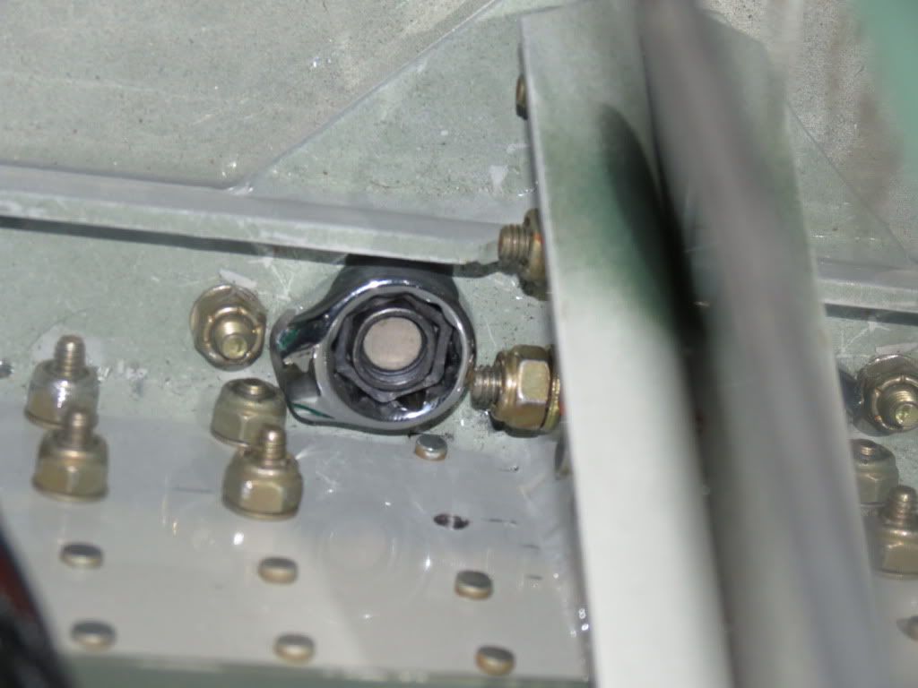

The longer I worked inside the RV-8 gear towers with vent lines, brake lines, all the weldment screws and wiring, the more I thought about laying on the cockpit floor trying to get a socket on those nuts when it came time to mount the gear and do annual condition inspections/maintenance. I have heard a lot of builders comment on the unpleasant task of working in those gear towers. Anyway, I think I have come up with a simple mod to make gear bolt/nut torquing much easier.
I purchased four inexpensive 9/16" stubby wrenches from Lowes at $5 each. I cut the box end portion of the wrench off with just a bit of the handle remaining and ground it to fit down inside the gear weldment where the outboard gear nuts are located. I cut, ground, and fitted each of the four "mini-wrenches" to fit the four bolts. Using JB Weld, I then epoxied the landing gear nuts into the wrenches and let them cure. Since the four special fasteners were custom fitted I marked them so I wouldn't mix them up during installation. Since pictures are much better than words I have attached a couple photos that should be helpful.
[IMG][/IMG]

Thanks for the feedback, Brent. I modified my gear towers as well to get a little more room to work but even so, it is a real pain anytime I need to do something inside the towers. Another nice benefit of this mod is that I should be able to check and torque the gear bolts/nuts without a helper.

This seems to be a really great idea. I used the same kinds of nuts but adding the box wrenches on is brilliant. I'm having trouble seeing any kind of a downside to this idea, except the very small amount of extra weight. I think I will be buying some wrenches.

I opted to go with the nuts that Van supplies in the kit for securing the landing gear. I have read, however, that some builders are going to the twelve point nuts for added strength. I would assume that the same approach would work for the twelve point nuts as long as you can find an appropriate box end wrench to modify. I wouldn't be surprised if a twelve point wrench costs a bit more. Still, if it results in added strength and peace of mind it is probably worth the expense.

I doubt the 12-point wrenches cost more...you found them at Lowe's for $5 each... (the wrench heads in your photos are 12-point)

Well DUH.... I never even thought about the twelve point nuts fitting the std 9/16" SAE box end. My immediate thought was the twelve point nuts would require a different and special wrench. This could be a first. A fastener that doesn't require another specialty tool.
Must have went brain dead for a few minutes.
