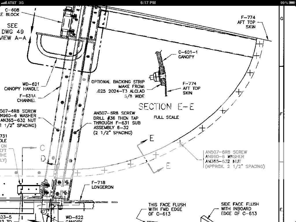

I believe the correct edge distance is 5/16" (2.5D) for the screws on the rear skin that hold the rear window in place, but that looks pretty skimpy. What have you guys done?

Thanks Vlad. Actually I am looking for the distance from the edge of the back skin where it joins the plexiglas of the window to the center of the screws used to attach the plexiglas to the skin.

The hint is in the cross-section E-E drawing.
It's in the middle of the 5/8 wide optional backing strip.

Thanks Gil, I saw that too, but wasn't sure that was the definitive source.
Since it corresponds with my initial assumption, I will use it and move on.
