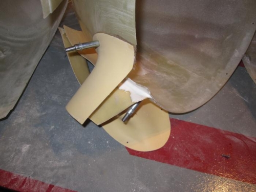

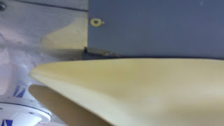

I have the RVBits fairing from Cleaveland too. Mine are the RV-10 version, but the concept is the same. As I mentioned on FB, I cut mine in half along the seam and epoxied them to the pant. I also added a micro fillet on the inside for a little more strength to the joint.Here's a photo in process.

Pretty. And then are the "front" and "rear" halves connected together at all?

Not on the fairings. Only attached at the wheel pant per plans.
Here's a finished photo of Vic Syracuse's RV-10 (his first one) that was taken at OSH a few years ago by Tim Olson.
You can view other angles here.
http://www.myrv10.com/tips/mods/Whee...ngs/index.html
As you can see, it saves taking out a few more screws when taking the pants off. I also think it looks nicer too.

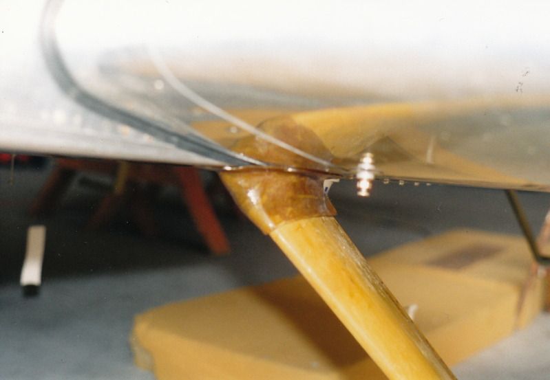

One more question. This -- although it's hard to see - is the rough fit of the upper right intersection fairing.
The rubber channel that goes between the fuse and the wing gap fairing goes all the way to end of the wing gap fairing. It also interferes with the intersection fairing and keeps it from sitting flush against the bottom of the fuselage.

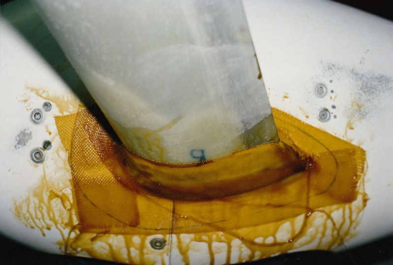

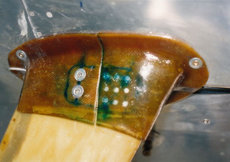

I made my own fairings for the intersections using the modeling clay, fiberglass and mold release wax method. The flanges on mine were molded in place and accommodate the rubber seal but with your generic cuff fairing you can add flanges, etc. as required. I would not leave a hard fiberglass end edge free to beat against the aluminum skin without some provision to prevent damage.
My lower fairings at the intersection of the strut fairing and wheel pants were done exactly the same as those shown earlier. I shaped the modeling clay the way I wanted it and applied mold release wax where I didn't want it to be permanently attached and laid up the first layer. You don't need all of that so I will stop on that process description.

Default Mounting of the upper intersection fairing
You need two cuts or seams in the fairings in order to install and remove them. In the upper MLG intersection fairings I chose to locate mine on the trailing edge and on the inboard surface rather than the more traditional inboard and outboard 50/50 location. You need three point mounting to stabilize the installation. The main part of my fairing consists of roughly 75% of the fairing as you can see in the earlier photos. Its three points are into the fuselage and the wing root closure strip. The other 25% is the inboard aft segment and its three points are one in the fuselage and two in an aluminum extension from the other part of the cuff.
Bob Axsom
