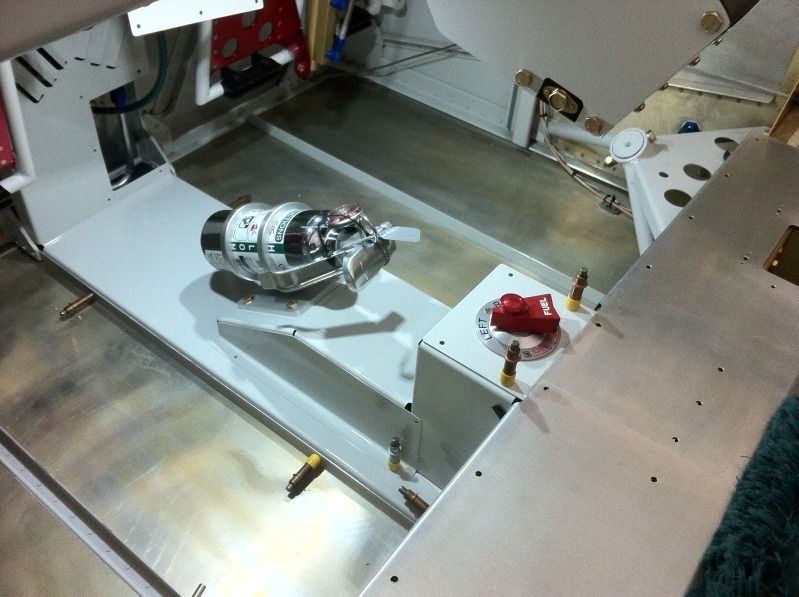

Originally Posted by Captain Avgas View Post
If you haven't got one, I highly recommend a small Halon fire extinguisher for the cockpit. A quick squirt up behind the panel in flight if required could stop a very small electrical fire from rapidly growing into a catastrophe. Once a flame has developed, cutting power will invariably not stop it spreading.
Happily, the aircraft wire that most of us use, has insulation, that will just melt off a red hot wire. And if other components of the panel aren't too prone, to easily igniting, you'll have a good chance of no farther damage.
I actually tested this out (not by choice)............before the plane ever flew. I had installed a heavy duty relay, intended to cut power from the alternator B-lead, in cause of a runaway alternator. This particular circuit, was later scrapped by the designer. What I didn't know, is that the relay contained several diodes, that were supposed to be removed for this application. As I sat in the cockpit, and turned on the power.........there was a big puff of smoke, followed by hot melting insulation falling on my trousers, just above the knees. I actually had a direct short, to the main ground wire, which is a #4, as I remember. It was bundled with many others, but the others were not effected. This is aircraft wire, with the white insulation. I no longer know the particulars, & name of insulation. The wire itself, was nearly melted through.
Note: I suppose we could conduct a flame test on Van's instruments, to see how well the support combustion, or not.
L.Adamson
Allan, Vans cheap chinese steam guages are notoriously shonky. You might have been a bit lucky that things did not get worse.
There you go Allen...... we need a source for an honest priced small (one hand) Halon extinguisher.

Old 08-12-2012, 10:47 PM
Flying Scotsman Flying Scotsman is offline
Join Date: Nov 2005
Posts: 1,256
Like this?
http://smg.photobucket.com/albums/v2...t=IMG_0267.jpg
