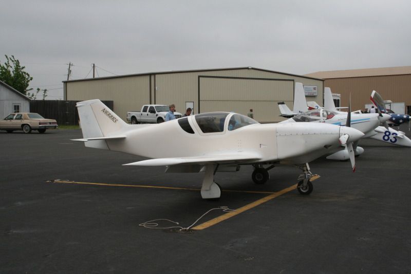

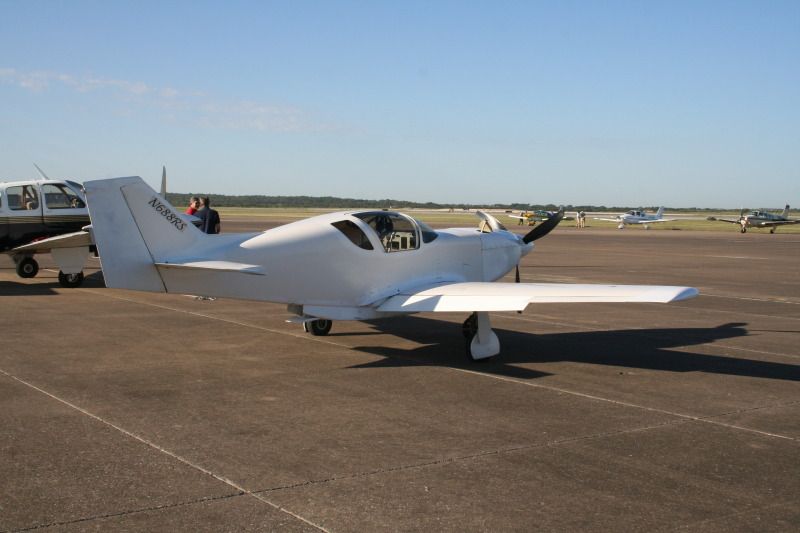

Unfortunately I do not know how to contact him. He had a tri-gear retractable Glasair powered by a Suraru and the speed was outstanding until a brake failure on landing took him into and off runway encounter with a ditch resulting in extensive damage. He has not even started a repair process and it may never fly again. I had the impression that he developed the P-51 like cooling system but I do not know that for a fact. The point is he had it on his airplane and it seemed to work perfectly for several races - he was untouchable. If a guy could talk to him about it I don't think the guy would come away empty handed.
