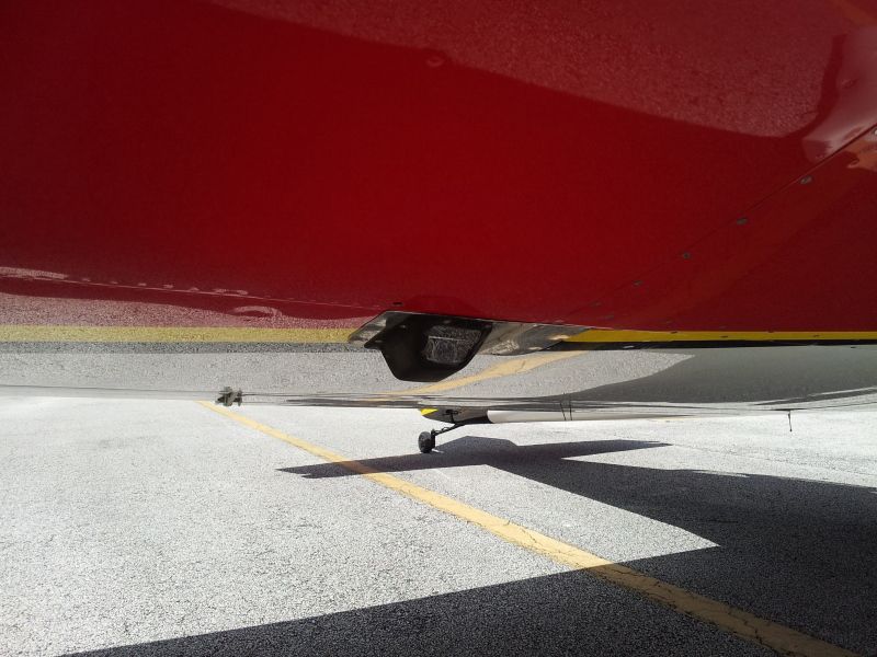

I wanted a wing cam that would allow remote control and would grab real time audio, including music, tower and intercom. I could not find it, and am not interested in dropping big bucks. So I took a M.S. Life cam, scabbed up a housing and mounted it to an .040 aileron inspection panel. I put a thin acrylic lens in and I need to replace it with glass I think since it seems to really get hit with the relative wind during climb. Anyway, it works pretty well and I have under $50.00 invested in the thing. The audio comes from a splitter on your headset I got from Skygeek. Should work pretty well for a flight down the Keys at 500 feet.

Have been wanting a cam on the wing that would be controllable from the cockpit and would get all cockpit audio. Was not interested in throwing money at the problem so here is my under $50.00 solution. Its not 100% yet but I'm not too far off. Took a M.S. Lifecam and scabbed up a housing from the reminants box of fiberglass, put in an acrylic lens and ran the cord to my pc laptop. Audio goes into the mic jack of the pc and is split from the headset audio from an A-dapter I got from Skygeek. I think the lens gets buffeted from the relative wind during climb so I'm off to buy a glass cutter and will put safety glass in version 2. Its mounted on an .040 duplicate of my aileron cover. Takes great landing video. I think a flight down the keys at 500' will be good stuff.

Thats the one, just grind all the mounts stuff off and lay glass over a piece of pvc of the same diameter to make a holder. I'll try to post a pic of the setup. I just record to Lenovo Youcam which came with the laptop. They have a cheap video editor if you need. I have not exprimented with different resolutions yet.

The lifecam cable was about two feet short of what I needed. I used a 5 foot extension. Shortest I could find. My mount is slightly in the way of the little "eye" the cam has, I think that may be part of the focus problems. If nothing else this gives me a mission to go burn six dollar a gallon gas. Have the itch to build, so I'm just building small. For now. I think this rig would be great in the cockpit.
