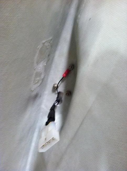

The key requirements are to follow the recommendation for using shielded wires, and to ground the case of the light to the black ground wire from the light within about a foot of the light.
The case ground for the wing lights can be done like this:
Note the ring terminal that grounds to the mounting screw and splices to the black ground wire on the light side of the connector. A similar thing should be done with the Suntail.
Please note that if you have the silver mounting bracket the anodization will need to be removed from the countersinks so the screw heads can ground the bracket. The gold mounting brackets are alodined so they are conductive.
The Suntail has a clear coating on the heat sink that also must be removed from the countersinks to allow the screw head to properly ground the body of the light.

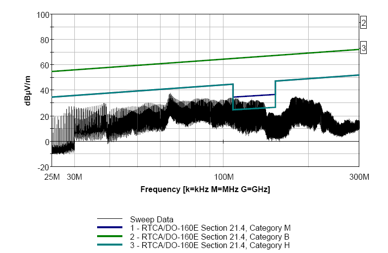

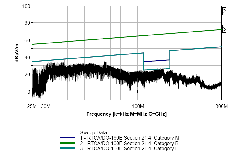

Here is what the position light RF emissions look like if the body of the light is not grounded, or the chassis and power grounds run separately over a long run:
Note the peak around 120Mhz (right in the radio notch).
With the grounded done as recommended, this improves dramatically:

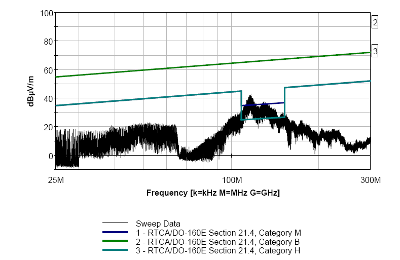

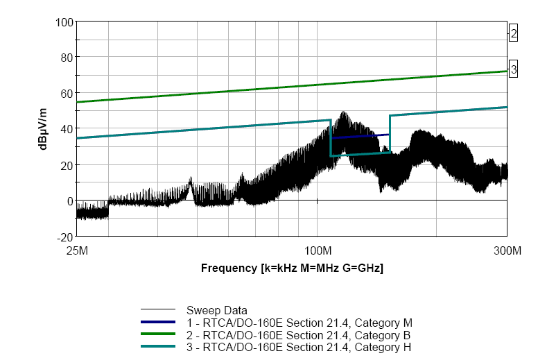

Likewise, here is the strobe for the ungrounded chassis:
Here is how it looks with the grounded done as recommended:
The step down in the limit lines for Cat M and Cat H are the levels that emissions need to be below to not be picked up by the radios. Cat M is the recommended level for most equipment, the extra margin of the Cat H line in the radio notch is for equipment mounted adjacent to a radio antenna.
I thought that showing these graphs would help make it more clear just how important following the grounding recommendations is for the lights to prevent radio noise. When the grounding is done per the above instructions, radio noise will be avoided.

OK, here is some help for the graphs:
Look at the part of the graph were the colored limit lines step down between 108 and 137 Mhz. This is the VHF airband that your Com and Nav radios use. If the black emissions plot is above the dark blue line in this band, that is a bad thing and you will hear noise on your radio from the lights. As you can see, when you don't ground per the recommendations, the lights create noise that is above the blue line. When you ground per the recommendations, the emissions are below the blue line. Every 3db is a doubling in signal intensity, so the 25db reduction in noise means that the noise signal amplitude is 256 times lower with the grounding than without.
Does that make the graphs more understandable?
