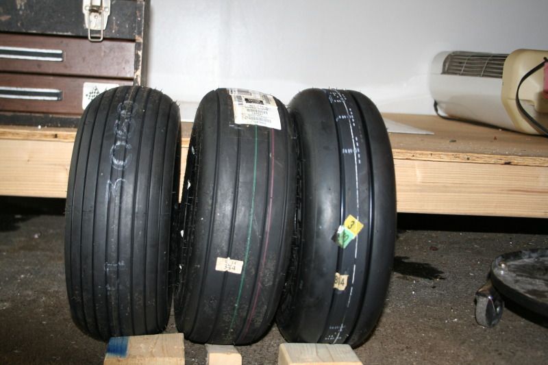

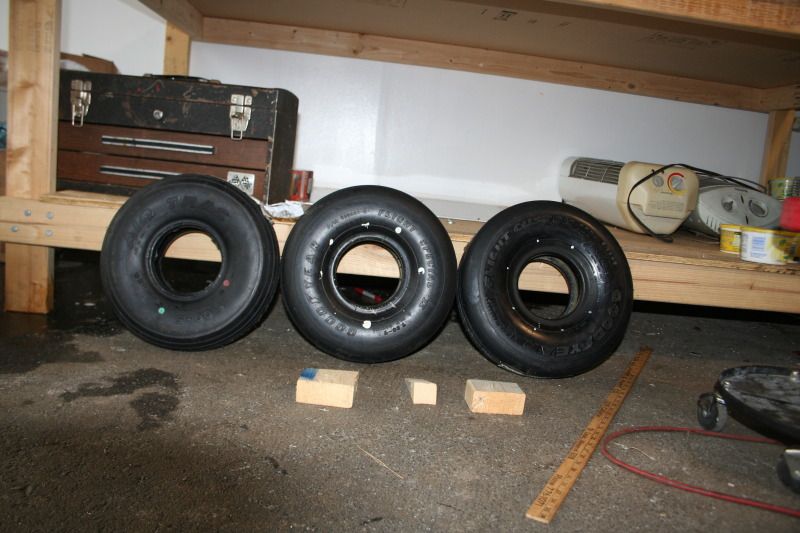

I weighed the tires and came up with these numbers:
Air Trac = 4.5 lbs
Flight Special II = 5.4 lbs
Flight Custom III = 6.6 lbs

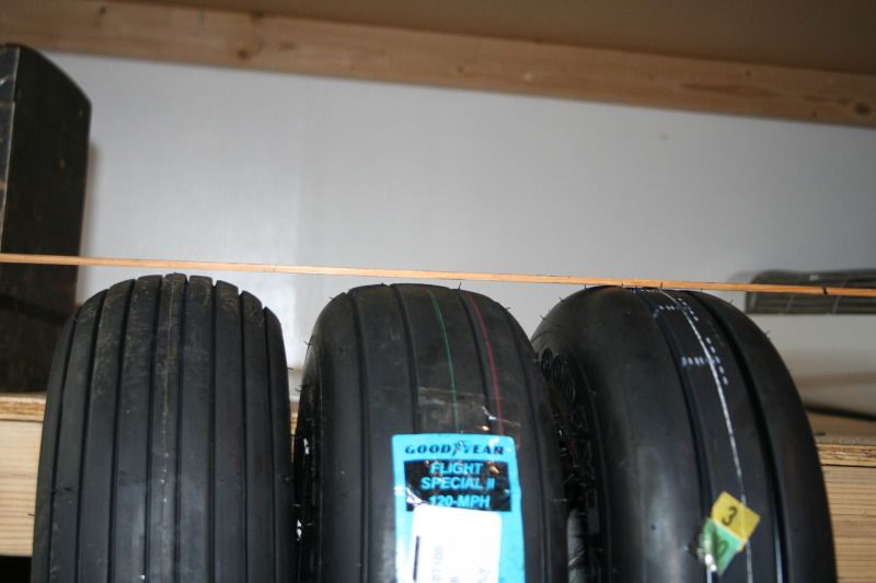

I photographed them and when they are grouped together the Air Trac is the one on the left and the Flight Custom III is on the right.

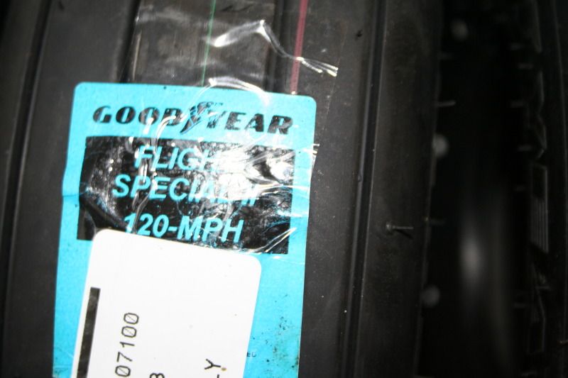

Note the 120 mph marking
Note the 160 mph marking
There is no speed marking on the Air Trac tire that I could see.
