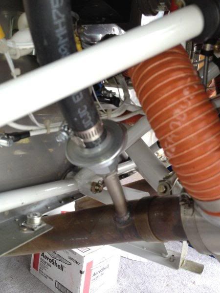

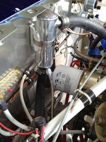

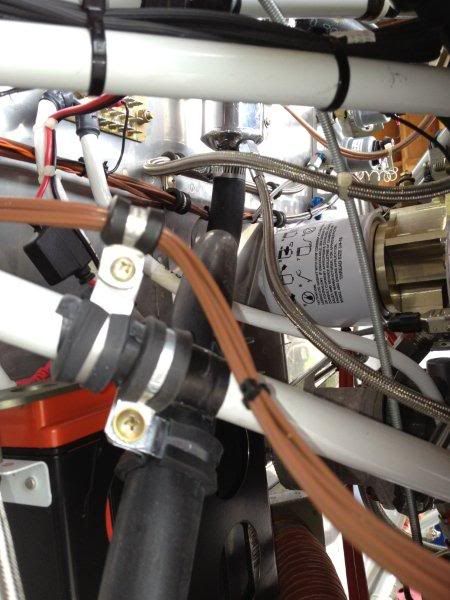

I've also installed the Anti-Splat Oil Separator and check valve. I was getting a lot of oil out the breather and onto the bottom of the airplane and antennas. I normally only run between 6-7 quarts of oil so I'm not overfilling and blowing out the extra. I just cleaned the belly after having the separator installed for about 25 hours. Very little oil and it was so thin it didn't really need cleaning. I am super impressed how well the oil separator works. Since I'm not blowing so much oil out the breather my oil consumption went from about a quart every 7 hours to a quart every 15 hours or so.
I used the standard rubber hose that Van's ships for connection to the aluminum breather tube (new one that wasn't shortened yet - CV Hose 9816) for connection from vent to the inlet of the separator. I used an identical one with a longer tail (about 30" before trimming) to connect to the check valve on the right side exhaust. It had the pre-bent 90 which worked well to turn the hose out away from the battery at the oil separator before going down. Both hoses are available direct from Napa.
For the small drain connection out the bottom of the separator going back to the crankcase I used the same braided hose that Van's uses for the manifold pressure line (VA-102). Of course your mileage will vary for length depending on where you locate the oil separator. And you'll probably need a 3/8" to 1/8" brass pipe bushing to adapt to the 1/4" hose fitting for connection at the crankcase. It's probably difficult to find a 1/4" hose to 3/8" pipe fitting.
I had a friend weld the check valve to the exhaust at the proper angle. The installation was easier than expected. I was very impressed with the quality of separator and mounting bracket. As far as a power increase.... you're probably asking the wrong guy as I'm not sure I could tell the difference between a few more horses. That's not why I wanted to install it. Below are a couple photos of my install. I'm a very happy customer just like with the wheel bearing mod Allan provided.
