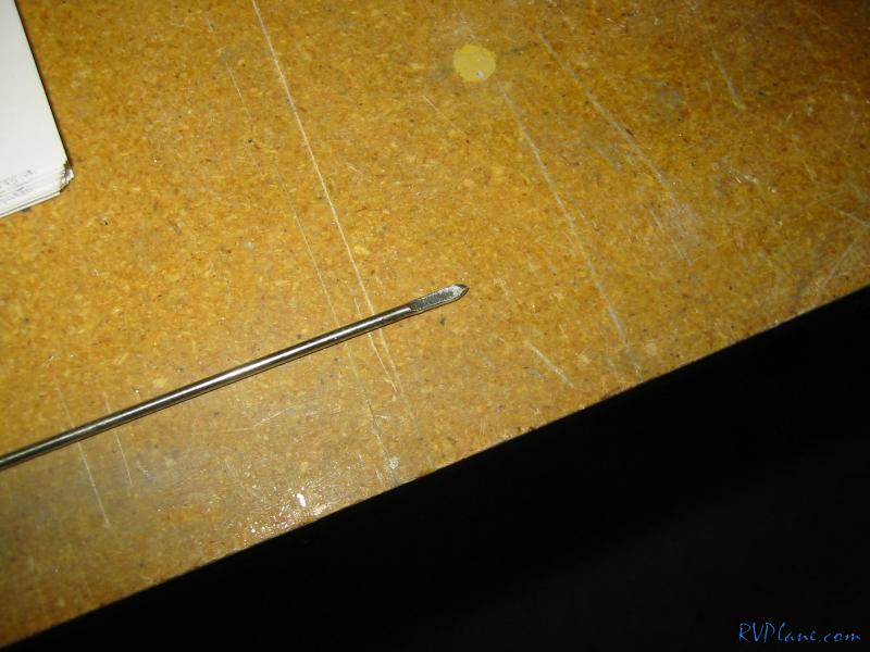

Instead of sourcing a thinner hinge pin, I enlarged the opening of the hinge eyelets slightly. I took a length of hinge pin and heated up the tip with a blow torch until it was glowing. I then used a hammer and flattened the tip. I then filed the end to a point. This increases the diameter of the pin at the tip. See below:
I chucked the modified pin into a drill and ran it at a low speed through my hinge eyelets that were binding. Slowly but surely, it opened up the hinge eyelets.
Another trick that really does make a difference is to lube up the hinge pins with BoeLube. I recently did some maintenance where I wiped down some hinge pins to remove oil. Upon reinstallation, I was having a heck of a time getting them to go in smoothly. After I added some BoeLube, they slid right on in. I was amazed at how much of a difference it made.
