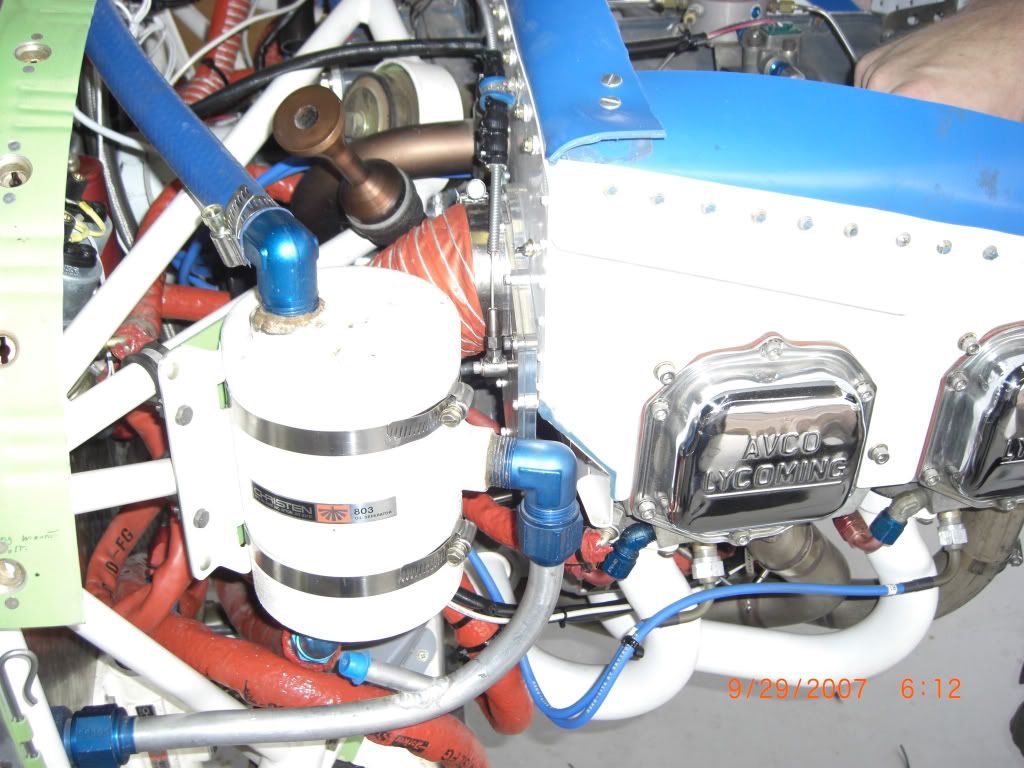

I installed a Christen inverted system in my 8 and I considered running the breather tube to the tail but decided against it because the carry though spar was in the way.
My Pitts S1S, and my Christen Eagle II had the tubes exiting just forward of the tailwheel, and I wanted to do the same on the Doll. Instead, I made the breather tube exit the oil/air separator, and aim at a Y in the Vetterman exhaust system. This turns some of the oil into smoke, but a small amount of it still runs down the belly.

Thanks for the picture, Danny!
Yes, I don't think I'll be drilling extra holes in the spar area either, I'll look things over more and figure it out. I like the idea of venting it at the stack. Rolling turns seemed to lose the most amount of oil in my other planes, and I won't be doing many of those in the RV, so it may be that it may not be worth doing for Sportsman type sequences. However the reason I ask is I've been instructing some basic aerobatics with a neighbor in his Starduster lately, with a Christen system but it does not have the breather going to the tail, and the left side of his plane is a mess after about 1/2 hr! So it may be a problem.

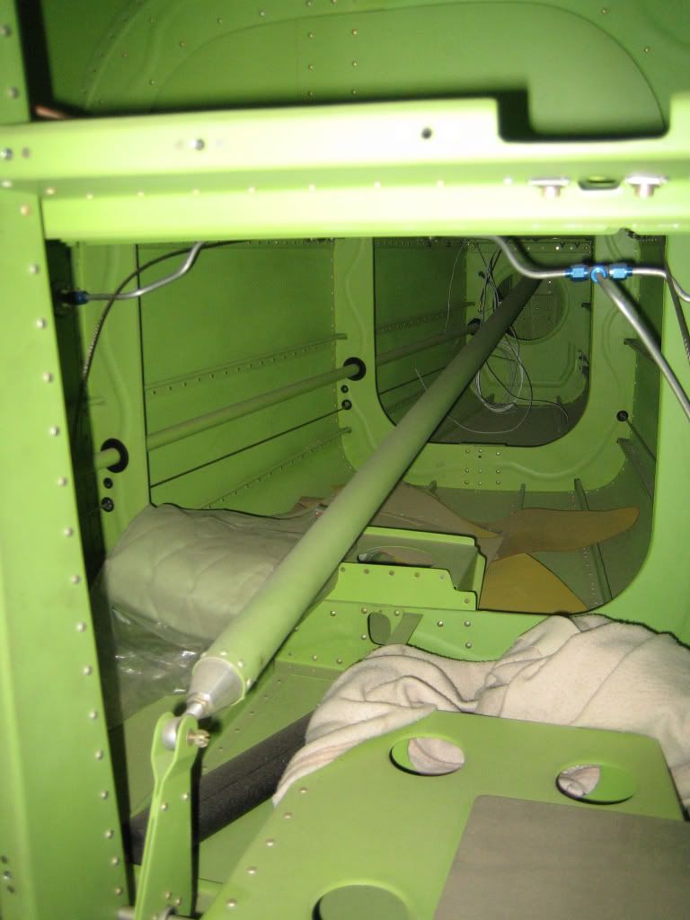

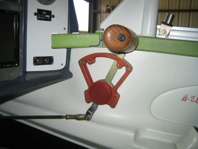

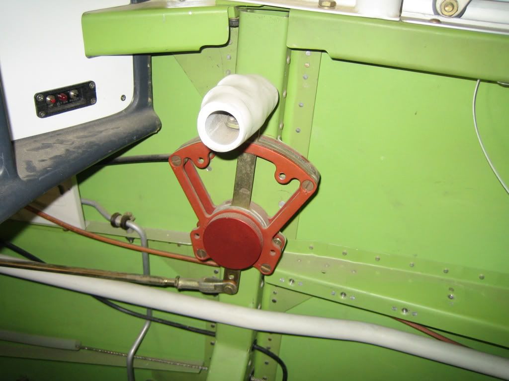

Heres how mine is the tube with the cap op is just in case it frezes it can blow the cap of and breathe that way
This white tube goes in my arm rest classic aerodesign
And going tru bulk heads to the tail if you want more info let me know works like a champ
