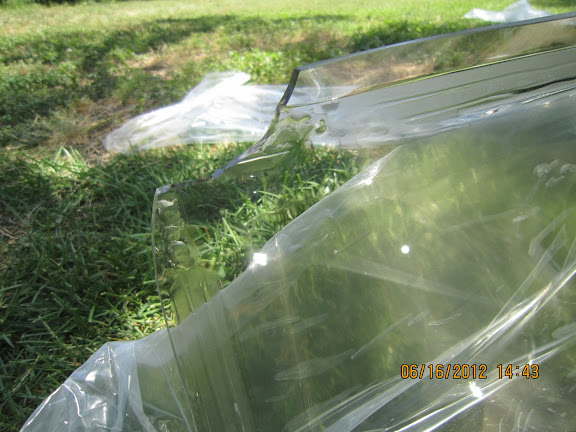

Is my canopy OK? The bottom edges on both sides are wavy and an aft corner is broken off. The broken piece wasn't in the box so I can only guess it was packed that way. Will both of these areas be trimmed off?

Yeah, you're gonna cut all that stuff. But it's still lame to pack a broken canopy.
One thing I would do is take a die grinder with a cutting wheel and slice across that piece , then progressively sand it smooth.
As it is, it seems to me, that's inviting a stress fracture to develop.
Of course, when i was building and slowly trimming sides and front, I'd sand it down to 600 grit on every pass as if it was the final product, just because I was scared to death of something cracking. Probably overblown fear, but it kept me honest.

Most of the back corners get chopped off so that chip should be no problem at all, just don't let it start a crack from there while working on it, I would suggest cutting that corner crack and polishing the edge.
The waves on the side should also be ok, at least 50 mm get trimmed eventually.

Thanks Bob and AJ,
Thought they would get cut off but wanted to double check before the inventory time elapsed.

Gus from Van's wrote:
It's OK.
All the wavy parts and the rear corner will be trimmed away as you fit the
canopy.
