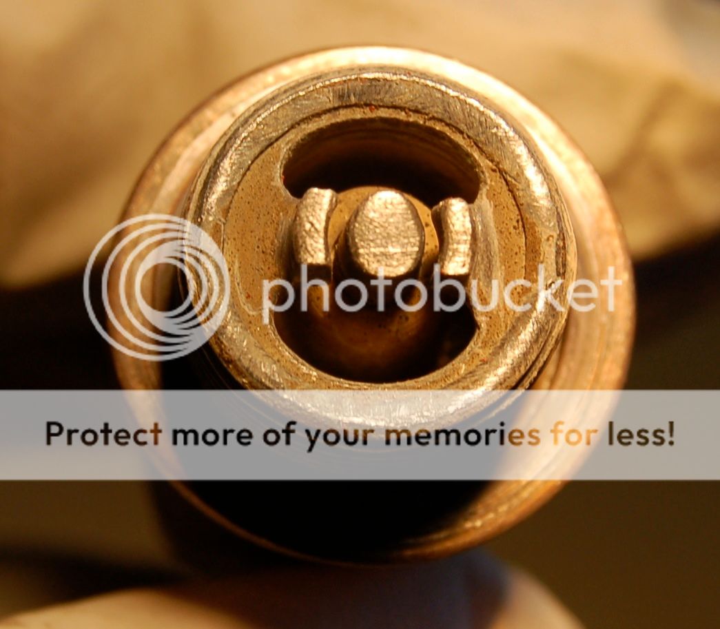

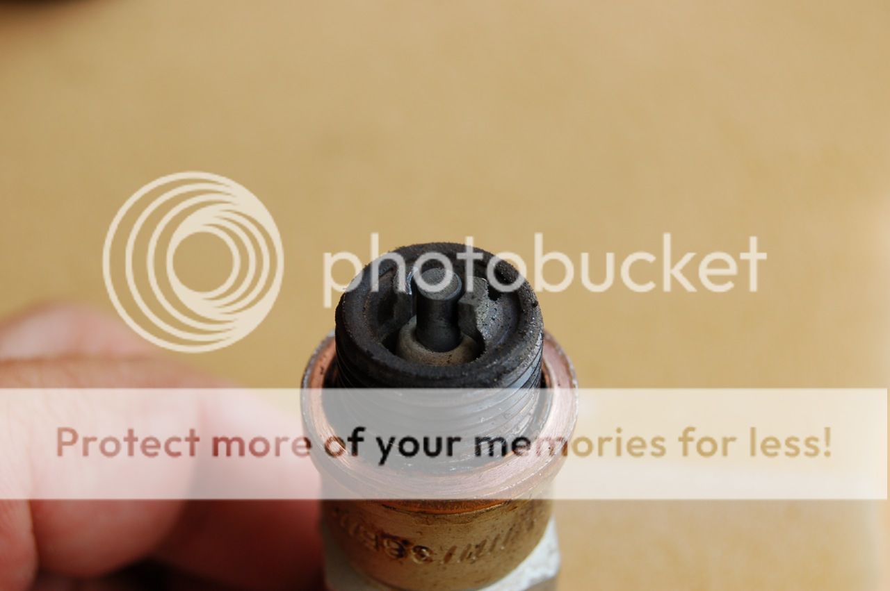

Just an observation. Plugs are checked visually, cleaned and rotated every oil change. Carburetor, conventional magnetos.
Electrodes at 40 hours.
The same plug at 400 hours.

That looks about normal to me for 400 - 600 hours - I was always taught that when the ellipse is 2:1, the sparkplug has done its duty and should be retired....and I figure 500 hours as a nominal life.

Every EI manufacturer should use these in their marketing material as a reminder what you won't see if you use Iridium auto plugs...
On a more serious note .. all looks normal there.. even if not exactly desired
