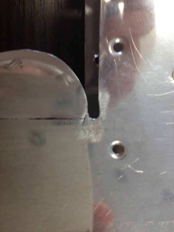

Building an RV7. The picture is of the bend tab on the left elevator next to where the trim tab goes. It is from the step where you bend the lower tab, then bend the upper tab over it. I accidentally bent it too far inboard and ended up with a small crack. I have straightened the bend back out and wonder what are my options at this point.
I have no illusions of building a perfect/flawless airplane, just a safe one. I can accept some cosmetic flaws.
My thoughts are I can either:
1- leave it as is, and rebend in the proper location (closer to the wing root) - probably not a good idea
2- stop drill it (basically make the pre drilled hole large enough to cut out the crack) and rebend (accept the cosmetic flaw)
3- stop drill, cut the tabs off and make a riblet (lots of work!)
4- order a new skin (even more work and $$$)
What do y'all think?

I vote #3. The extra work is minuscule in the context of the whole plane (though be careful on using this logic... in aggregate it can get you in trouble). #1 doesn't seem good, as you've said. Because you've re-bent it already and would have to do so again, I don't feel good about #2. If you're going for a show plane, by all means go with #4, but that's probably not required for a safe solution.

I would take a small round file and enlarge the existing relief cutout to capture the crack. Follow that line as if the existing notch was that big to begin with. Do the same to the mating piece to keep things "looking" right. As an experienced sheet metal guy, the question I ask myself is "what does it do, and what happens if (or when) it breaks". That particular 1/4" of material doesn't do much, and as far as of how it works, as long as the crack is cleaned out and it doesn't recrack when you bend, you should be golden. This kind of "blend repair" gets done regularly in the certified world.

I agree that opt 3 is a good option. However, I don't think this part really bears any load, so a riblet might be overkill. Furthermore, since I am not too concerned with the look (especially since this is the bottom of the elevator) opt 2 seems to be sufficient.
If I did opt 3, the other issue would be if I left the riblet flange oriented so I could buck standard rivets, the riblet would not sit flush on the edge. On the other hand, if I turned it around so that it sat flush on the edge, I would have to use pop rivets (not very aesthetically pleasing). Either way, it wouldn't look right.

Andrew, that is kind of what I was thinking with opt 2. Thought I could probably clamp it to my drill press and enlarge the hole to encompass it. I doubt the rebending of the metal is a big deal since it isn't load bearing.

Took the words right out of my mouth. This is exactly what I would do. Verify with Van's to be sure.
