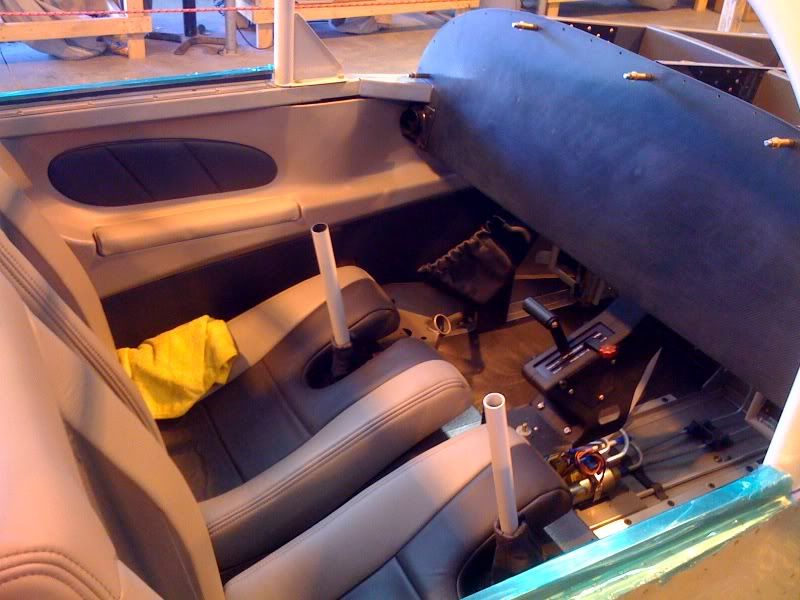

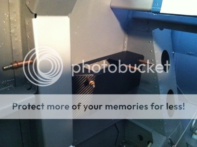

3M carbon fiber has texture. It's not the shiny clear coat look. I did carbon on the inside of the skirt and side panels. I contrasted that with 3M "brushed steel" on the instrument panel. (also with real texture). If you are looking for interior carbon to over-lay on the existing panels or covers send me a PM or email. Let me know the total sq ft you'll need and I can help.
Side note: 3M uses invisible "air-release" which help prevent bubbles. 3M uses control-tec which allows you to place and replace the vinyl. Only after your satisfied with the "lay", then you apply squeegee pressure activating the adhesive.
