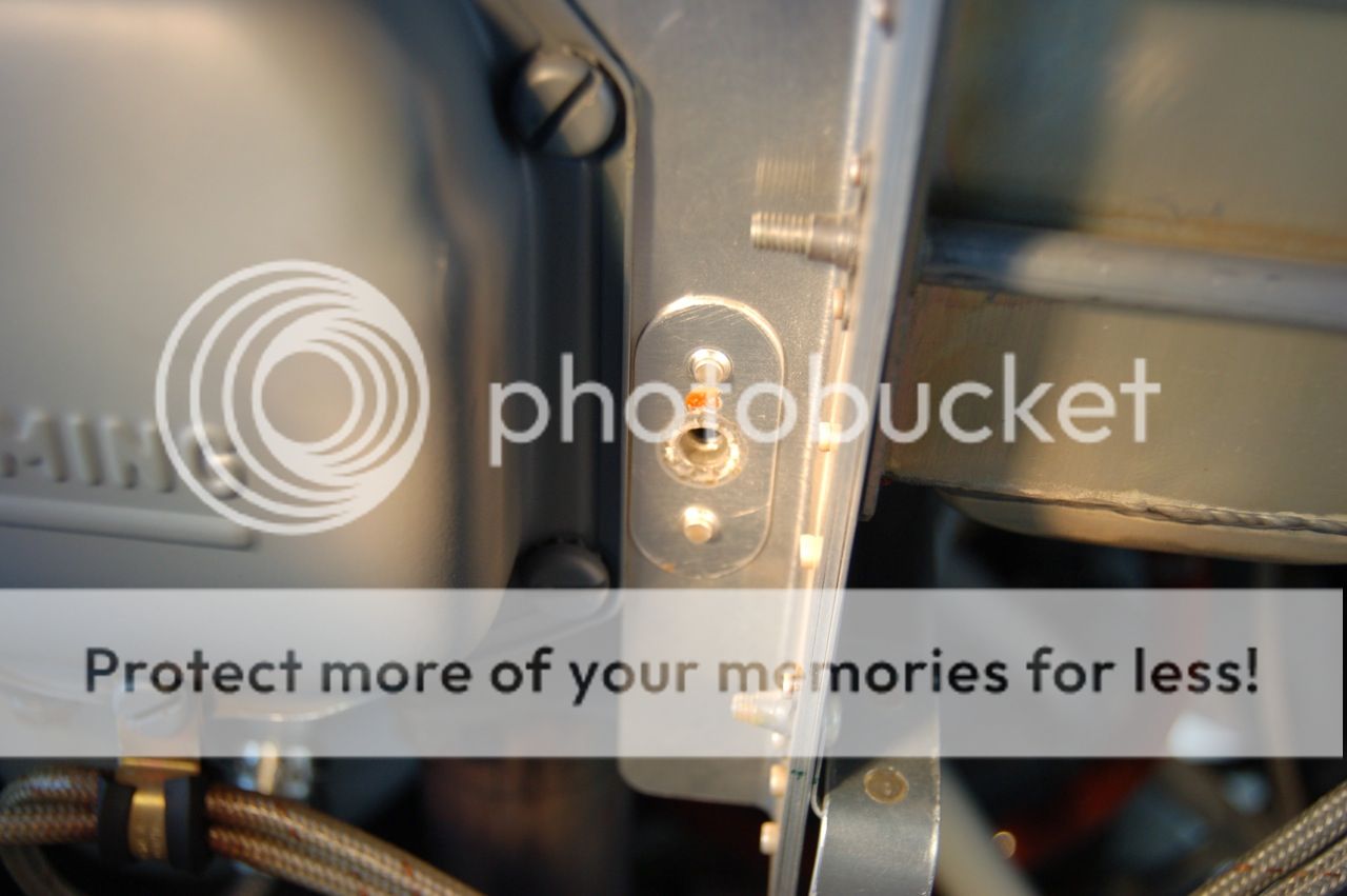

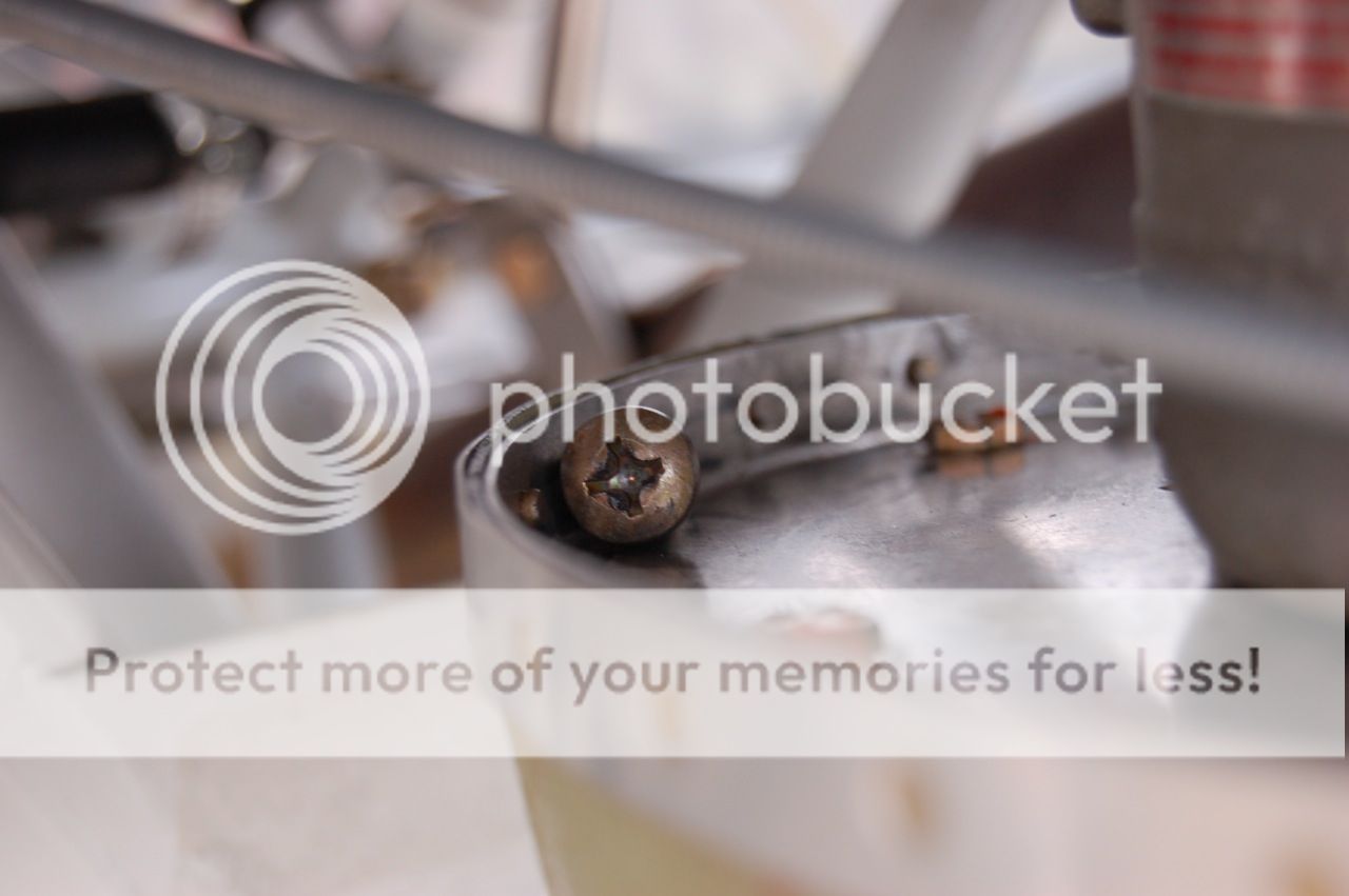

Michael if you have opportunity to safety wire them, do it. After second 100 hour inspection I found a screw on my airbox
After long investigation and digging the specs from builder's manual I figured out it was from here
All of them had two washers flat and crush, were properly torqued and marked during final assembly. All of them needed tightening. I would suggest safety wire if you can figure out points of securing it. Unless you are talking about something else...

From the appearance of the picture it looks as though the star washer was against the aluminum doubler on the baffle. If this is the case, this may have been why it loosened up. It should be screw, star washer, flat washer and then baffle. Maybe it was that way and the picture just looks funny, but I have seen hundreds upon hundreds of installations where the screws are not safety wired and the fastness have never loosened up when installed with lock washers and flats and torqued.

That IS the case Mahlon you are right thank you very much. The star washer was against the baffle. This weekend I will check all of them and reinstall properly. Details, details. Love the community!
