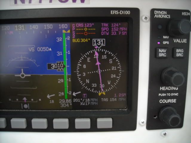

Brad, there is no IFR 'certification'. You simply comply with FAR 91....something and install the required equipment.
My -10 is IFR capable with two Dynon screens...an EFIS and an engine monitor. The EFIS is set up so that my "Home" screen at boot-up is split with an HSI on the right, where my nav/approach info is displayed.
I also have an SL-30 for localizer and glideslope approaches and a 430W for precision RNAV/LPV approaches and file as /U.
If you're ever in my vicinity, you can fly my -10 left seat and we'll go 25 miles and shoot a few LPV apps.
Notice the winds aloft from 201 degrees at 18 MPH...it's calculated for you continuously between the GPS info from the 430 "speaking" to the D-100...amazing...even the crosswind component shows and if you study the HSI, you can see the wind correction angle!

The information in those links was incorrect...
VOR receiver is NOT required.

Secifically CFR 91.205
(d) Instrument flight rules. For IFR flight, the following instruments and equipment are required:
